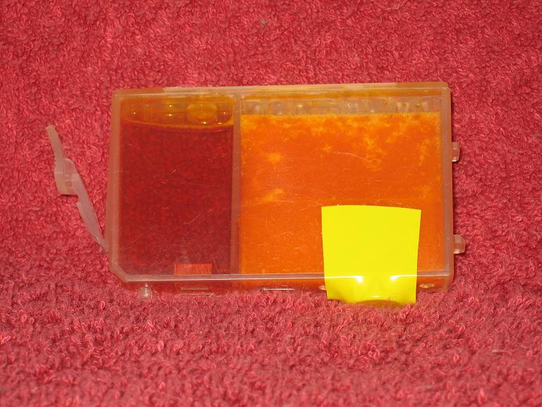

mikling
Jul 2, 2006
3,239
1,472
Toronto, Canada
http://www.mediafire.com/file/e11w5i2o6wk0h2r/Sponges.rar
LINK DELETED. See further down.
are pictures that I am sure many will want to look at. The german refill fans will find some pictures that they may interesting and for the thinkers it should pose some questions. I do not have time to go through them all but they are numbered sequentially and this will indicate what I have stated. They go much beyond the excellent work that ghswellsjr has done with the pictures on the porosity that a certain person claimed is identical.
I may start another thread at some point to explain the pics, but these pics will clarify why "head pressure", direction of sponge fibers, etc are pretty much non issues. Again the final pictures should be eye openers for those who still don't understand how the reserve tank works...and how to ensure that it works the way it is intended.
Enjoy.

7,171
Enjoy.
Looks like bloody murder happened!
Look forward to context to clarify the pictures.
martin0reg
May 9, 2010
1,060
748
273
Germany Ruhrgebiet
@mikling
Thank you for the pictures, explanation would be helpful...
The last pictures: is the ink chamber filled with ink?
If so, they might tell that the "two chamber design" (beside the two sponge design) holds the ink unless it is sucked out by the sponge!? Or am I totally wrong?
Since I think about the two chambers I have to think of the "constant pressure" bottle of this ciss:
http://www.youtube.com/watch?v=A7k8yKQwF6c&playnext=1&list=PL4E793C447D54205F
- but the chambers are interchanged compared to canon What will happen if he opens the plug of the big chamber, would the water in the small chamber hold?

mikling
Jul 2, 2006
3,239
1,472
Toronto, Canada
martinoreg
mariotte bottle...google it.
A little bit of physics
Re: video
When was the last time you saw ink consumed and dripping out that fast out of a printhead? under very low flow other forces are much more significant. I explained this before. That while it is valid ignores many other more significant issues.
My university fluid dynamics classes go back to the late 70's that is why I am very rusty at applying the numbers to this game.
and YES the tank/reserve is FILLED with ink/fluid in many pictures and it is not coming out. So how does the ink come out of the tank???????? you'll soon find out why.
