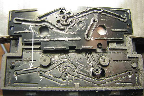

Well, it happened again. This was on a different i9900 and involved a different print head, but the problem was the same. I suspect that there is a design flaw in this print head (shared by the i9900/i9950/Pro9000/Pro9000-II). The problem began suddenly, with all of my prints being green. A nozzle check showed that the PM was completely missing. A head clean produced a perfect nozzle check, but printing even a single 4x6 produced banding and then green. A subsequent nozzle check showed a little PM at the top and bottom of the head, but nothing in the middle. I wont bore you with the details, but several different carts (included freshly refilled and purged&refilled) all gave the same results. I even tried a (GASP) OEM cart in the PM with no improvement. The purge pads were clean and a cleaning cycle always gave a good nozzle check, so the purge unit wasnt a suspect.
Because there was nothing to lose, the head was pulled apart as described in the first post in this thread. One improvement was to use the screwdriver bit shown below on the top left. It fit the screw heads perfectly much better than any screwdriver that I have. The photo on the top right shows that the rubber seal was doing a good job. After a quick alcohol purge, it was easy to see through the print head as shown on the bottom left, so the clog wasnt in the print head itself. As before, the clog was in the plastic body. The clog wasnt a total plug, allowing small amounts of ink to pass thats why a cleaning cycle gave a good nozzle check. When larger amounts of ink were required to print a photo, the clog wouldnt let enough ink pass, and the ink link was broken.
The clog was worked loose by pushing/pulling on a syringe filled with alcohol for about 10 minutes. Even after this much effort, it was obvious that more pressure was required on the syringe to get flow in the PM than in any of the other channels (but still a big improvement oven when I started). Since no further improvement seemed possible, it was decided to just put it together and try it. As was mentioned previously, it doesnt seem to be necessary to replace the plastic nibs holding the circuit board in place, so this step was skipped (bottom right).
As a way to demonstrate the difference in flow through the PM and other channels, two pieces of 3/16 ID vinyl tubing were installed and filled to the top with alcohol. Note that the PM only dropped about as fast as the adjacent channel. In any case, the cleaned head was reinstalled in the printer and everything was back to normal all of my PM carts now work OK.

FANTASTIC Post and amazing information and pictures! Thanks so much Grandad!
I'm very glad that you were able to successfully restore the PM... while reading I was almost convinced you were going to be stuck with a bad head.
Based on what I know about you, I was surprised that you didn't keep trying to get the PM as free flowing as its neighbors. How did you know when you felt the amount of cleaning was sufficient vs. powering through until the clog was completely cleared?

Over the years, I have developed a good sense of force and speed. Once the clog began to break up, it was clear that there was little further reduction in the force required on the syringe after 2-3 minutes. At 10 minutes (about 3x the time required to initially break up the clog), it was judged that there was nothing more to be gained. Even at the 1 drop/2 second value given in the first post, that is far more ink than is required to print (less than 8 drops of a single color for an 8x10).
Also, I remembered from my original post that the PM flowed more slowly than the other channels after the clog was cleared and that it still printed OK. I suspect that the PM channel in the plastic body is longer/smaller in diameter/has more bends than the other channels, and that this is why so many problems occur in the PM channel. Wasn't there another fairly recent thread about a clog in the PM on a Pro9000 (which uses the same print head)?

I really wonder what that clog was?
My experience with similar push pull procedures with the pressure on a few printheads reveal something similar in that for some reason, sometimes you would experience higher pressure to push all of a sudden. As if there was total blockage, then after a few pulls, the clog would appear as if it disappeared altogether and the pressure to push was down markedly. I could never really figure out what was going on and this has happened to myself more than once. The only thing I could think of is there was some foreign material inside that shifted positon but I never took the printhead apart to verify this as that might have been destructive.
Grandad seems to have gotten a knack for disassembling these printheads and reassembling successfully. Maybe he can start a service here. Rodbam, tried taking his apart and it appears his endeavor was destructive.
As for the pathways, yes. The pathways are definitely not straight as the bird flies at all. You can tell this immediately with 5 cart printheads where the dye black is placed far away from the other dye cartridges yet the nozzles are with the dye group thus necessitating a long path to the printhead nozzles. I can't remember but I think the i9900 nozzle positions are also not analogous to the cartridge position. It's been a while messing with this printhead. The longer narrow path will definitely result in increased resistance.
Also be aware that the smaller printheads/narrow nozzle strips/slower printers will have more resistance than the wide printheads like the i9900/pro9000 so a sense of feel with a consistent syringe is required.
These operations should only be attempted as a kind of last resort. The pressure phase of the operation can be destructive to older heads if prudence and some experience with feel is not applied.

A while ago I was given a print head that was fried. This seemed like a good time to look at what was inside the plastic to see the flow channels. The head was mounted upside down in a vise and the bottom sanded down to the point shown on the top half of this image. This makes it clear that the plastic portion of the print head is made from 2 parts. The bottom half of this image shows the process of popping the bottom cover plate (on the top in this photo) from the main body. The cover plate was very difficult to pop off, and required a lot of force with 2 screwdrivers. Note the numbers 1-5 on the bottom half of the image - these correspond to where the ink enters from the left cart (1) to the right cart (5).
This photo shows the two pieces after they were popped apart. Note:
1. The ink flow channels are molded into the cover plate, and the ink channels are bounded on both sides by raised bosses fit into the grooves molded into the main body.
2. The parts smell like phenolic when sanded, and do not exhibit any tendency to melt, as would be expected with phenolic (a thermosetting plastic). The normal way to fasten these parts would be to use an adhesive in the grooves.
3. On the left side, note the 2 arrows pointing to a spot on both halves. This is where a portion of the raised boss broke off and was left in the groove.
The numbers on this image correspond to the numbers in the preceding image to make it easier to follow each ink path.
4. Two of the ink paths (1 and 2) have two exit points molded into the main body and the cover plate. This allows the same cart to feed 2 sets of C and M nozzles (for large and small drops).
5. I caused a lot of damage with the screwdrivers - if I had it to do over I would sand the plate completely off to get a cleaner picture of the ink channels.
This photo shows the 5 ink pickups corresponding to 1-5. #4 is for the pigment black.
Another question was "what is inside the ink pickups? The head was sanded down from the side to get a cross section of the #1 ink pickup. The top half of this image shows the process when about 25% of the ink pickup was removed, and the bottom half shows the process when half of the ink pickup was removed. No "fibrous material" was seen, only a sintered metal surface screen and a clean hole.
After seeing what's inside, the plastic portion of the print head should be able to withstand well past 100 psi for cleaning, as long as the sintered metal covers aren't deformed by direct contact with the air nozzle and the nozzle plate itself is removed.
It is also easy to see how some adhesive could spill out of the grooves during assembly only to later break free. Other than this possibility, it is difficult to see how foreign material could get into the channel, unless something in the ink itself precipitates out and suddenly breaks free.

Did you sand right through the nozzles and all the electronics?
Are you suggesting that we could use very hot water or other liquid for cleaning without risk of damage? But even if this were true for the parts that you show, it may not be true for the electronics region, would it?
