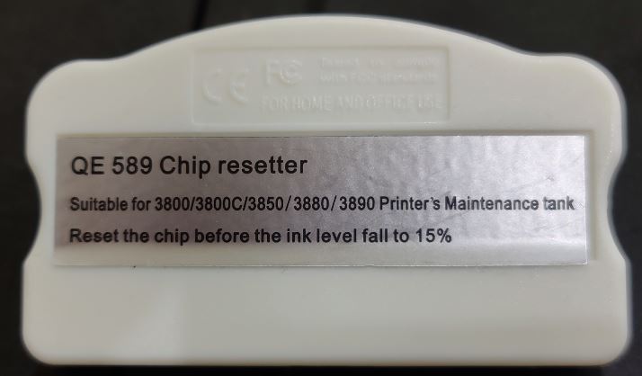

OK, the chip resetter works!
Not quite the way I thought it would, though.
The chip resetter appears to reset empty (fully used) maintenance cartridges. The LED flashes red a few times, turns solid green for a few seconds, then turns off, but my printer will not accept them.
Doing a little more reading I see where InkOwl says their chip resetter (which appears to be identical to the one I purchased for $21 on Amazon) will not work on a completely used cartridge.
I don't remember Jose Rodriquez saying anything about this in his video for the PRO 3800 and 3880, so I will assume this is a difference with the P800.
So I ordered a FOURTH maintenance cartridge, so I would have two good cartridges to go with my two used-up cartridges (that don't have a spot of ink on them.)
I was a little nervous because I had just learned how to determine the used/unused capacity of the maintenance cartridge (through my RIP software & also on the front panel) and the cartridge in my printer that I had installed a week earlier, which hasn't been used to print anything and has gone through 2 or 3 heavy head cleanings was down to 69%. Almost 1/3 of the cartridge used!
Once I received the new cartridge, I reset the cartridge in the printer and...the printer accepted it! I did not need to use the second, unused cartridge to get the printer to accept the original, reset cartridge.

I bought this resetter on Amazon for $21:
QE 589 Chip resetter
One of the photos makes it appear that the resetter will work with ink carts, but the description on the item's label clearly indicates it works only with the maintenance cart.
Would you mind sharing the instructions for resetting the maintenance cart with the resetter you bought from Amazon? The instructions on Amazon seem geared toward ink carts.
Hmmm, I can't find the box & don't remember if there were instructions, but it's as simple as pressing the resetter against the Waste Ink Cart, the light will flash red a few times & then go either solid red or solid green. If it's solid red, keep trying until it goes solid green. Job done!
These are the "instructions" on my resetter. Note: It specifically states it is intended for the maintenance tank:

I also purchased the QE 589 on Amazon. The product info indicates it works on Ink carts and also on the WIC. When I read the instructions on the label you posted, I interpreted the 15% to apply to the Ink carts, not the WIC level since it specifically says "ink level" and not remaining capacity. However, it might be a language translation issue.
