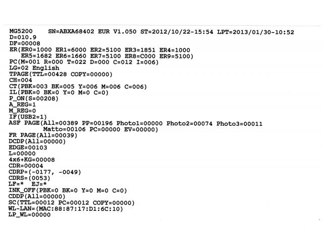

BTW could you upload a scan of the EEPROM printout. Only the part with the larger print is needed. The small print HEX info is not needed. Maybe I can spot something wrong?
eeprom scan

I see that ink monitoring has not been disabled, so that cause of problems is ruled out. It is the line : INK_OFF ( PGBK=0 BK=0 Y=0 M=0 C=0)
Starting from the top, here is the info I am able to decipher and also some guesses: MG5200 is the model number indicating that European and American models very similar,. SN=........ is the serial number, EUR shows region is correctly set to Europe, V1.050 is the firmware version ST=......... is the date and time for first print or installation. LPT=...... is the date and time of the last print. D=... is the D-value and DF=...... is the DF value, which seems much too low.
The next line starting with ER is interesting. It is a record of errors, both service call errors and operator call errors. From the service manual they translate to:
ER0=1000 is an operator call error, meaning no paper in the rear tray
ER1=6000 is a more serious service call error meaning line feed error. This can have a lot of causes, some harmless some serious, see the service manual p. 10/62
ER2=5100 is a service call error meaning carriage error also potentially serious with many causes, see service manual p, 10/62
ER3=1851 I couldn't find this. As the number is low, <2000, it is probably a harmless operator call error.
ER4=1000 is an operator call error, meaning no paper in the rear tray
ER5=1682 is an operator call error meaning ink cartridge not recognised. The chip is possibly defective.
ER6=1660 is an operator call error meaning a cartridge is probably empty.
ER7=5100 is a service call error meaning carriage error also potentially serious with many causes, see service manual p, 10/62
ER8=C000 is a service call error meaning drive switch error, potentially serious, see p. 13/62
Did you have some paper jams? That could explain the service call errors, or were the timing strip and disk stained by ink? or was a cartridge not properly installed and blocked printhead movement?
I don't know this: PC(............
LG=02 English means English is chosen as language.
TPAGE( TTL=00428 COPY=00000) is a page counter meaning that 482 pages were printed in total and no copies were made using the printer as a stand alone copier.
CH=004 means printhead number 4, meaning that the printhead was replaced 3 times or removed for cleaning outside the printer 3 times. Have you had problems with clogging of the printhead?
The CT(..... line shows number of cartridge changes, maybe 1 should be subtracted from each value, as with the CH value?
IL(... I read somewhere that this is ink level in cartridges, and it can have the values 0, 1, 2 and 3. I don't know if 0 means a full or nearly empty cartridge.
P_ON is probably number of times the printer has been powered on.
A_REG=1, M_REG=0 could mean that the printhead has been aligned automatically once and never manually. It is a good idea to do a new alignment if the printhead has been removed from the printer, and a manual alignment printed on high definition paper or matte photo paper is more accurate than an automatic alignment, giving better photo print quality.
IF(USB2=1) probably something with interface. Could indicate if the printer is connected via USB or via. wireless
ASF PAGE, ASF means Automatic Sheet Feeder. This could be a page counter for rear tray or it could be from the cassette. Total number of pages from this paper source is 389, the other numbers indicate what printing media was chosen and the number of prints on each media.
FR PAGE is a page counter for either the cassette or the rear tray. Note that ASF PAGE+FR PAGE=TPAGE TTL or 389+39=428
DCDP(ALL=00000) maybe number of printed duplex pages if the printer has this capability?
EDGE=00103 , L=00000 probably some alignment values.
4x6+KG=00008 Could this be the calculation of the DF value?
CDR=00004 could be number of CD's printed.
CDRP:(-0177, -00489) most likely CD alignment value
CDRS:(0053) probably also a CD alignment value.
LF=* EJ=* are values for alignments made in service mode.
INK_OFF ( PGBK=0 BK=0 Y=0 M=0 C=0) means ink monitoring was never turned off.
SC(TTL=00012 PC=00012 COPY=00000) is number of scans with a total of 112 all scanned to the PC no scan as a stand alone copier.
WL-LAN= .......... is the printers MAC address.
LP_WL=00000 could indicate that the printer is not connected via wireless
I cannot tell from the info why the DF-value is so low. It might be related to many printhead cleanings from the printer maintenance tab. Many cleanings in a short time might cause the value to go low.
The EEPROM data tells the service technician a lot about the printers history and usage. I guess that is why the EEPROM cannot be reset with the newer versions of the service tool. I think this is related to warranty conditions. One must not be able to delete the fact that the inklevel has been disabled or that the printhead has been removed, possibly for cleaning outside the printer. Also in some countries warranty is also limited by a number of pages printed.
