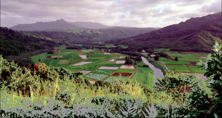

Tin Ho,
Thats a nice landscape shot. Just for fun, I decided to see what could be done with it.
1. Since it didnt have an embedded color space, I assumed that it was sRGB and assigned that as its color space. Without an embedded color space, you cant be sure that your photos will be printed as you edit them.
2. This shows (in gray) the areas that are out-of-gamut in your original. Note that just because a color can be defined within a color space does not mean that it is guaranteed to fall within its gamut. These colors are guaranteed to print differently from what you see on your monitor.
