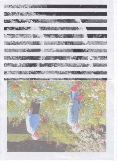

I don't know if this will work. This is the image of the colour print and then the same picture printed in black. This shows the result of a Greyscale print job sent from the computer. It did work !!

Hello The Hat, I have had some trouble in uploading the picture, I have done so, but it is not connected to THIS string. I see that it in page 2.
16,162
9,114
Johnmorag said:
[url]http://www.nifty-stuff.com/forum/uploads/thumbs/8997_canon_mp130_test_page.jpeg[/url]
You done a good job with your upload and it can be seen quite clearly.
Now for the bad news
Your print head is fried, bad, dead, finished no longer usable.
Youll have to get yourself a new print head if you want to print greyscale normally again.
Now I know you said your printer works with only one cartridge present,
but if you look at your print out again youll see the direct result of that, a fried print head.
You need to keep two cartridges in your printer at all times and be very sure that theres ink in both of them
before you start to print anything, otherwise youll damage the print head beyond repair again as this one clearly shows.
I am sorry I cant offer you a cheaper solution to your problem except to say be careful when you install a new print head
because it needs ink inside it to function correctly, stay cool and to print, even if you are not going to use any black in your prints.
It might be wiser to consider buying a new printer as a cheaper alternative to buying a print head.

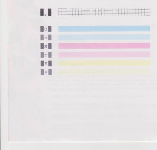

As requested.
This is the Canon MP130 nozzle check image. It is easy to see that there are one or two gaps in the grid, but the most important thing is that the bottom half of the grid is missing, in the same way that it shows up on a black print job.

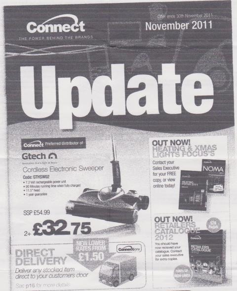

For general interest, this is a BLACK copy of a colour image, using only a BLACK ink cartridge (ink tank) in the printhead, to prove that it is only using black ink. It is not perfect, but as it does not show the blank white stripes, how does that indicate that the printhead is blocked?
