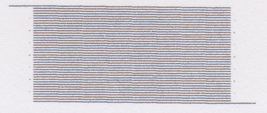

Better late than never. Here is the test page. Couldnt fit the whole pic so extracted the colors only. if needed will post the rest of the page. This is after washing the head and two cycles of print head cleaning. To me it seems bad..
Better show the whole page.
I once had a similar problem, colored letters and weak light bars (also no real stripes) in the normal nozzle check.
In the extended nozzle check the color bars were clearly cut (=electrical damage) .. not like yours...
...BUT there had to be three (!) bars of magenta and of cyan also in the extended nozzle check
1 - extended n c of the one with the colored letters and weak light bars
2 - extended n.c. of a good one (may be except for the blue square..don't really know how it should look like..)
I am not sure what yours should look like...but as the normal n.c. is the same (with three bars for M and C) I would expect also three bars in the extended n.c.

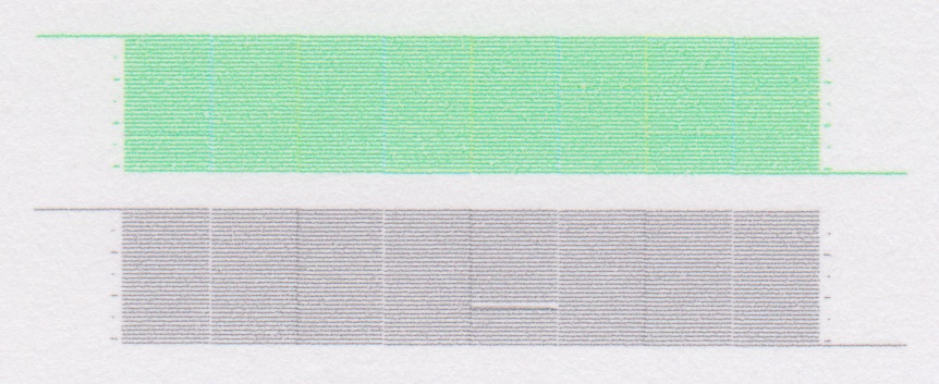

Extended nozzle print from service mode is OK.
I have checked some old SMode test prints from MG5150 (stored in "hardware" folder) and it has only 2 bars (strange, cause printhead has 3-sizes of droplets).
Also MG5250, MG6250, iP4850/iP4950 also have only 2 bars and iP3600 (one gen older) also have only 2 bars.

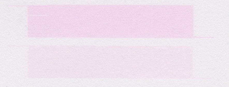

Here are the lower test figures
what do you make of it?
Łukasz
Jul 3, 2014
250
138
Poland
MG6250 (MG5150 before)
To me it looks like Magenta ink tank is filled with Light Magenta Ink (instead of Magenta).
Ł.
5,130
5,012
Light magenta is also called photo magenta, so is your magenta ink bottle labelled "Photo Magenta"?
Ł.
MP540 - three bars (and same printhead..or not?)
http://www.printerknowledge.com/threads/need-help-for-my-mp540-printhead.8523/
(see post 7 and 10)
Question remains: is there no third bar intended - or is it missing in the print?
We should make a collection of correct extended nozzle checks - without this it's really difficult to interpret your check
PS: aleksandar, a post of the whole page could help...
The correct version of extended nozzle checks you can find in service manuals...if those are available...
5,130
5,012
MP540, iP3600 and more printers use the same QY6-0073 print head as the MP560.
According to the service manual only two cyan and two magenta bars are intended. I don't understand this, maybe it is a program error in the printer's firmware? See post #25 for an example of the extended nozzle check for MP560 from the service manual.
