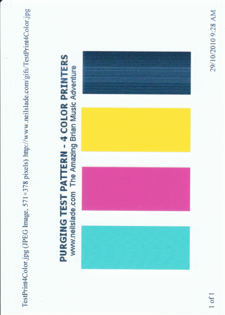

Canon MP610 black not printing from computer

Jim, your bottom picture of the Purging Test Pattern looks to me like it was printed on plain paper--actually, I believe you either told the printer that you were using plain paper or the default was set to plain paper. The black ink that is used on plain paper is the pigment black ink from the large cartridge that shows up in the nozzle check at the top of the page which has a perfect nozzle check. Can you print the same image but tell it that you are printing on matte photo paper and see if it is any different?

Besides the obvious missing ink in the nozzle check, there appears to be a checkerboard pattern in at least the Cyan and Magenta, though this could just be an artifact.

Jim Attrill
Oct 25, 2010
Sorry, I've been away for a couple of days.
I have also had some further problems which required multiple head cleaning to clear.
I've had the MP610 for 30 months and I can buy a replacement MP640 or wireless MP560 for about the cost of a full set of Canon cartridges. So Iam close to going that route.
0003 is printed from a scan. 0002 was photocopied. 0004 is a nozzle check - all on plain paper.
0006 was printed on glossy photo paper.
I tried uploading a larger selection of the photos from my mousemat but Nifty wouldn't recognise them as genuine PNG so these are cropped to a quarter of the original.
