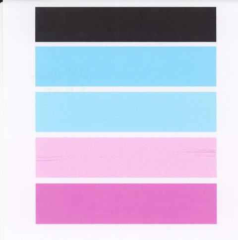

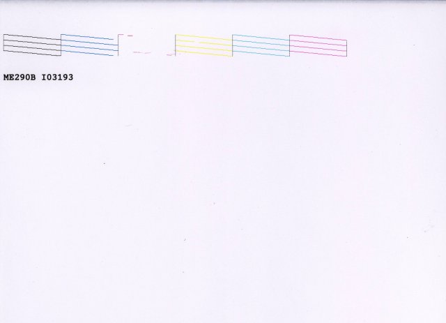

Trigger 37
Dec 23, 2006
607
136
Mike, TinHO,.... I want to take back the last post I made. I jumped the gun again. Because the nozzle check looked good and the bars print looked good I felt the problem was solved. But late last night when I tested it one more time, what I saw was that there were no streaks in the bar chart but the colors were totally wrong and it turned out there was no yellow at all. Where the Magenta bar should be is a pink bar, nothing even close to Magenta. I'll scan the print and upload it.
Now when I do a nozzle check, there is practically no Magenta nozzles at all and no yellow, but now the Pc, and Pm are OK.
If I go around in a circle one more time I think my head will break off. Here is the bar chart.
And here is the nozzle check.
You can see that the magenta printed in the nozzle check did not print but the yellow did print perfect. However, in the bar chart the Magenta is the 4th bar from the top and the photo magenta is the 5th bar, and you can see it is really not magenta at all. The sixth bar was supposed to be yellow and it is missing. These two prints were done 30 seconds apart. This ink cart is a new Vendor cart. The black ink cart is the original Epson T007 refilled.
What I can understand is how it can switch back and forth.
