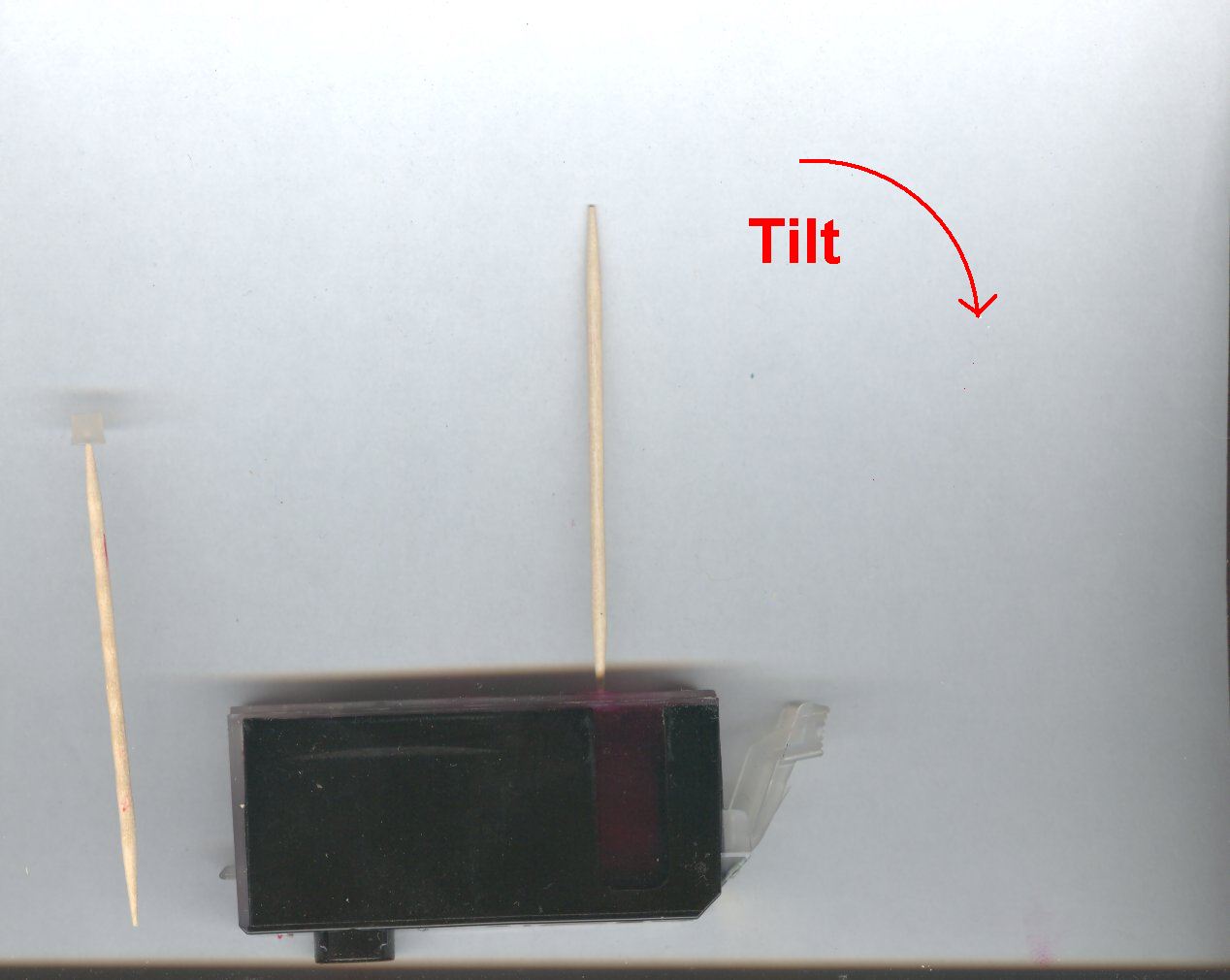

I have found that a wooden cocktail stick/toothpick is a good tool to insert and remove these low profile plugs without risking them jumping away.
To remove the plug: insert the cocktail stick in the hole in the plug without piercing the plug and tilt the cocktail stick. To insert the plug: insert the cocktail stick in the plug without piercing it and use the cocktail stick as a handle to insert the plug. Then push the plug down with a finger and apply aluminum tape to keep the plug in place and provide a seal.
Being located in Europe I got my plugs and aluminum tape from Octoinkjet.uk
Here is a picture showing how to use the "tool". click to enlarge:

Neat idea. Too bad hobbicolors plugs don't have a hole, as insertion of their smaller plugs is difficult, particularly if the hole is snug, plus they are hard to hold. For removal, I pry them up with a cuticle trimmer under the silicone "flange". I wish there was a tool to hold the during insertion, as fingers get in the way of the view. Perhaps if I modify the cuticle tool....

Peter/BJ Thanks for toothpick tip I use the same plugs and they are good but tricky to handle, particularly with gloves on.
