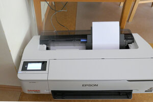

My Epson SC-T2100 arrived, I got it installed pretty easy, it is printing with the setup cartridges as delivered, I'll go and profile my roll papers in the next time. The printer does not do much internal activities between commands, it is much more responsive than the Canon printer.
The printer - as the image shows - has the display at the top at the left side - much better than on the Canon TC-20 at the left front, and the Canon display is much smaller. I can turn the printer and roll it under the table when not in use.
