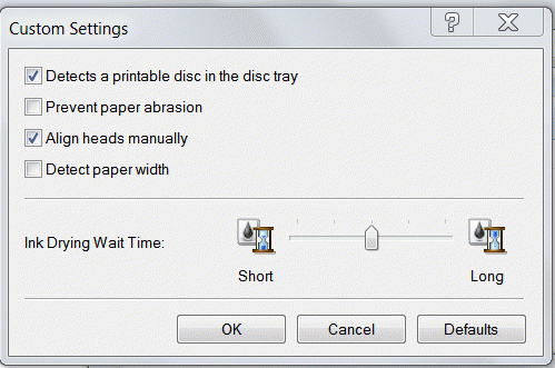

This is probably what mikling was talking about when he mentioned slowing down the ink drying process..
http://www.nifty-stuff.com/forum/uploads/5128_drying_time.png
Mmm no screen grab graphic!!!
In what program does that screen appear? I have nothing like that in either the 3880, or the ColorMunki........well, not that I have found yet!

On the 3880, you have the extra facility of ink density. Look hard, there are a lot of options on the Epson driver . The Canons have less options thus far. Canon needs catching up in the driver area.
Canon is found in the "custom" settings.
The Epson is there once you dig in a bit.
The colormunki I believe does not provide any type of ramp situations to assess the suitability of settings in a given paper.

Prints made with the following settings on an Epson 3880 - Media type Photo Quality Ink Jet Paper (no color adjustment) Paper config. settings (below)
Colour Density +10 - + 50
Drying Time +10 - +26
Paper Feed Adjustment -28
AND
In Lightroom 4
Print adjustment Brightness + 61 - +80
Contrast +50 - +79
This has been a game changer @ CD +50; DT +26; PFA -28; LR Print adj Bright +61; Contrast +79 is as close as I can get to what I saw, given that even on my EIZO the illuminated screen is going to skew what will print. The paper is taking the additional ink density ( Cone Pigment) and it is drying perfectly flat.
It took 9 x A4's to get me there but it IS worth the effort :rolleyes:
