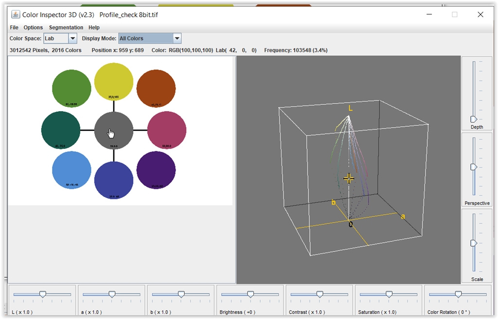

As promised: a quick check of the absolute colorimetric accuracy of my printer-profile combo.
Printer: Epson Stylus Photo R3000
Profile: 779 patches, ArgyllCMS, X-rite Eye One Rev. D
Test target: 8 saturated LAB-values inside the profile gamut + 1 neutral patch printed using absolute colorimetric rendering
Results in deltaE 1976 (deltaE 2000)
Yellow: 6.7 (3.2)
Red: 9.9 (3.1)
Magenta: 4.7 (2.1)
Purple: 3.7 (1.5)
Blue: 2.7 (1.9)
Cyan: 8.9 (3.9)
Green: 9.6 (2.8)
Lime: 6.5 (2.0)
Grey: 2.8 (2.8)
To summarize: these are relatively large deltas. I am not sure if this is normal or not, but besides some hue changes in blue-cyan sky tones I cannot detect any differences between prints and monitor softproof (everything calibrated + a proper viewing environment). Everything looks great on print.
Keep in mind that dE1976 is actually not the best formula to evaluate perceptual color differences. I am big fan of the updated dE2000.
If anyone wants to repeat this test: I attached the target as a .TIFF file.

Thanks for your test and feedback, I'm aware that the DeltaE2000 better matches numerical and visual color variations but I'm not really doing any visual tests of this type, I just like to have a numerical value for color differences I can use for comparison, and they are supposed to be small anyway.
I'm looking to your circled color patches and wonder if we are using the same scales and measures - I converted the file down to RGB 8 bit accuracy, and my graphics program tells me that the gray patch has a color of R=G=B=100 which is about 40% of 255, you specify a Lab value of 50, 0 , 0 - L=50 is the midpoint of the L-axis from 0 to 100 , which would correspond to a RGB=127 value - not 100 - I see similar differences with all the other colors - is there a hidden Gamma or another factor causing this ?
Have a look to the numbers just above the graphs showing the Lab and RGB values when you mouse over the
color patches when you use this Java program.
Your file contains plenty more colors than 9 - 2016 in total - which are caused by the interpolation around the
coutline circles, and all these colors are shown as little dots in the Lab space. You may better use rectangles to prevent this.
It seems you are not using the embedded ProphotoRGB (gamma=1.8) color space, but likely sRGB or Adobe RGB. I double checked the RGB numbers in the correct color space and it should translate to the LAB values I wrote down. E.g. RGB (prophotoRGB) 100,100,100 = LAB 50,0,0.
Yes, that was my oversight, I checked and yes - there is the ProPhotoRGB color space which includes a gamma value which I somehow expected ; I typically use sRGB on this level which needs less attention overall
