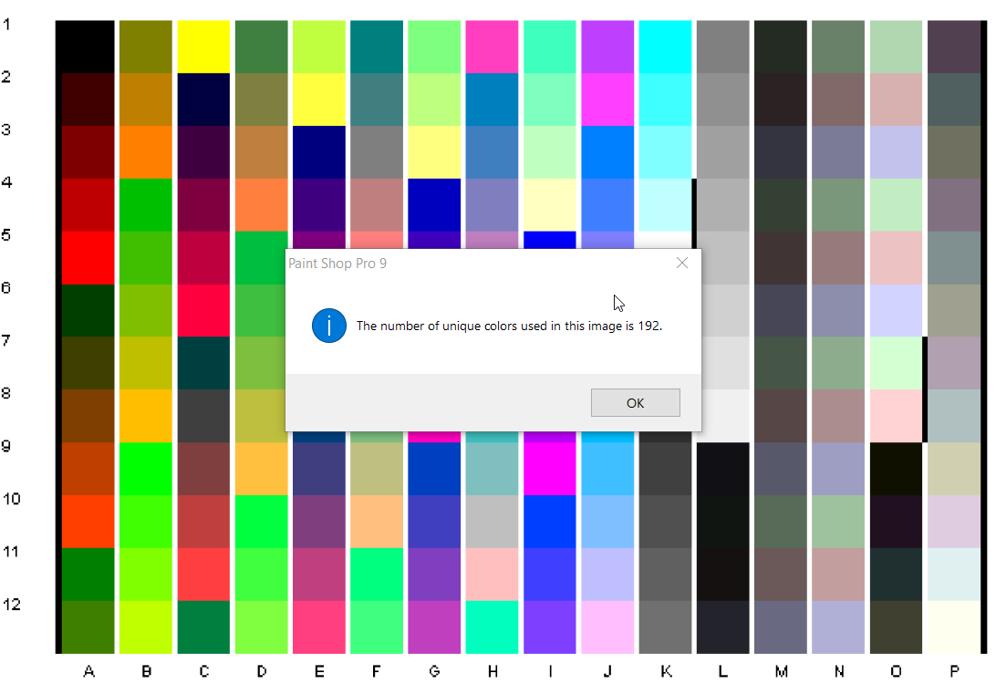

PaintShop just gives me the number of unique colors - nothing more - no value or location in an image file whatever.
But I could find a way to export the patch file data from the i1Profiler editor as a tab separated text file with the RGB values but again no location data within the patch sheet but it most likely arranged in a left-right - top - down scheme in a sequential table.

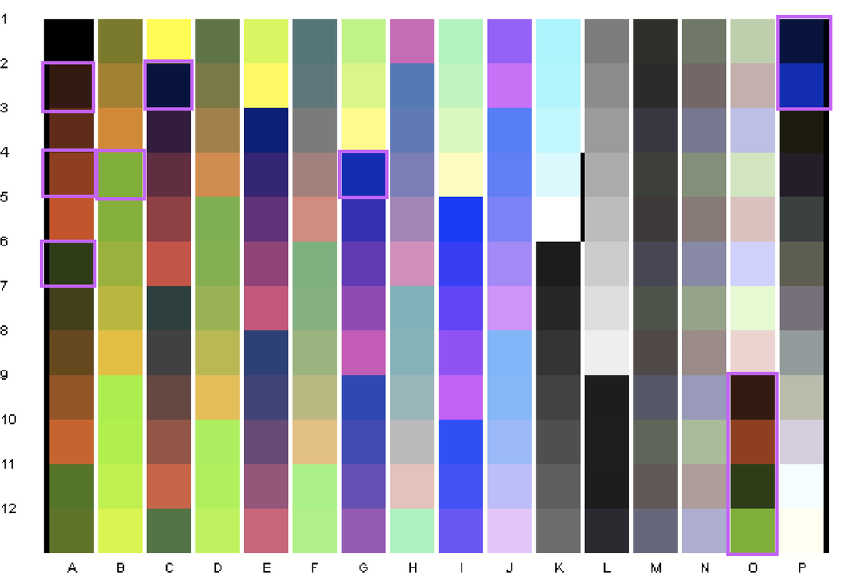

I think I might have found the doubles and removed them. I think these are the last 6 RGB patches (with different hues) before the near neutral patches. I replaced them with extra near neutral patches. The pink outlined boxes are the doubles I have detected.
The new target looks like now:

@pharmasist - it works - I printed your 192 patchsheet on a 10x15 cm card and scanned it with the i1io2 robot - it works !!! - that was some great work you did to create the necessary parameter files and patch sheet.

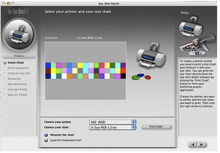

I hope you will report back and see how this target will perform compared to a larger patch size target like 729 or even 2880 patches. If the average difference will fall under Delta-E 1, than it is practically indistiguishable compared to much larger targets. The 165 patch target was already satisfactory (thinking it has a few doubles too, making it a 159 patch target). I think it has twice the amount of patches of your 96 target. Note: GretagMacbeth original simple printer target has only 45 patches (eye-one match):
