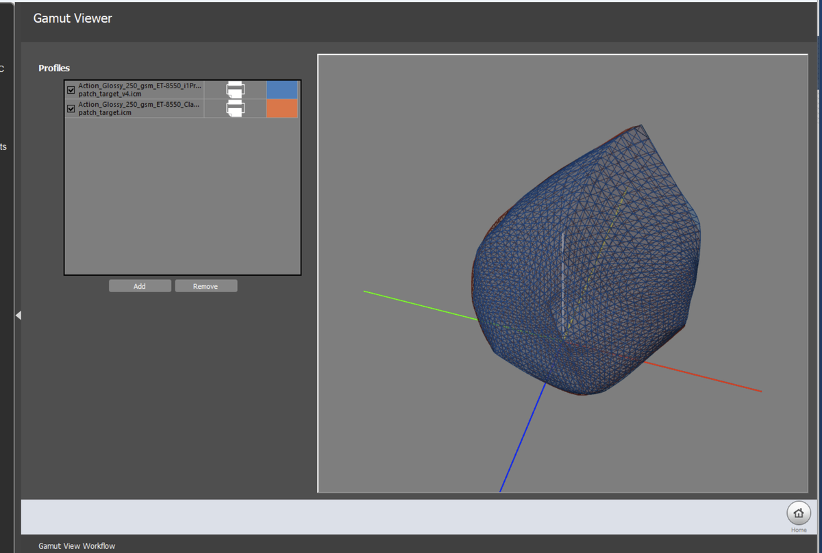

Inspired by @Ink stained Fingers I generated a small 165 patch target that can be printed on a small 10x15 cm/4x6 inch photo card and with some modifying the grey and near neutral patches in the patch editor in i1Profiler to obtain an optimum patch distribution in the RGB color space I could generate a very good printer profile with only 165 patches:
Above a printer screen in gamut view (i1Profiler) between the 165 patch target (blue) and the 581 patch target (orange). They are practically the same in volume size and almost identical.

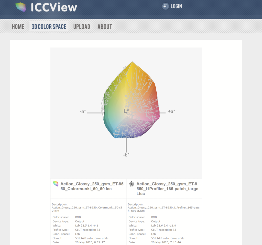

Actually the target is even better than the 50 + 50 method of the Colormunki: the ccStudion/i1Studio method uses a interpolation method between 2 points in the color space not taking care about the intermediate points if the behaviour is not linear (curved behaviour), which gives some problem like in the example below between the 165 patch target (i1profiler but I generated a v2 version so iccview.de could handle it) and the Colormunki profile:
You can see clearly the wired cube in the green/blue/yellow area of the color cube (165 patch target with i1profiler) can cover a significantl area that is not covered by the 50+50 Colormunki profile (the colored cube). I had this problem in the past on my P800 using a chinese pigment refill ink with a particular light cyan version that was way too light causing a strange gradient in the blue skies, that I could only deal with using the ArgyllCMS method (480 patches), before I could hold on the i1Pro2 spectro.. Note this profile is for the ET-8550 using original ink, so if you use the Colormunki method to create the profile: please take: probably you need an optimization scan with some green/blue colors to improve that area. The simple 165 patch i1Profiler profile does immediately a good job and is on pair with a larger 581 patch target.
