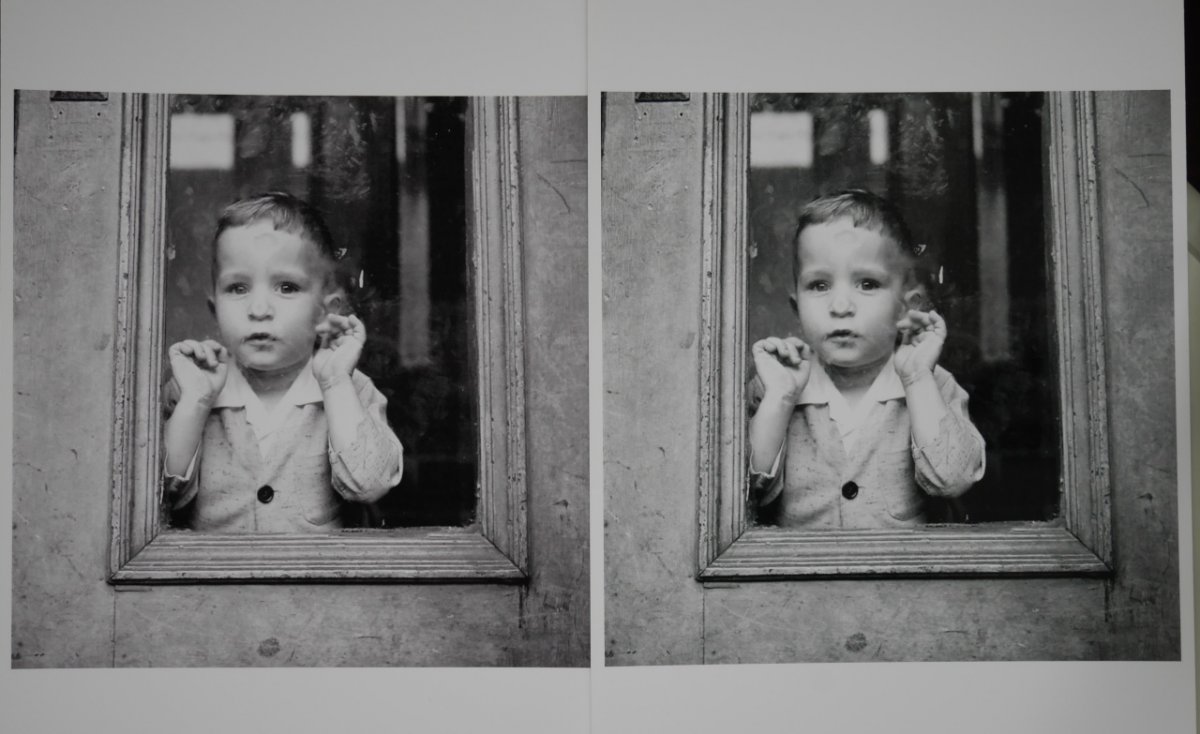

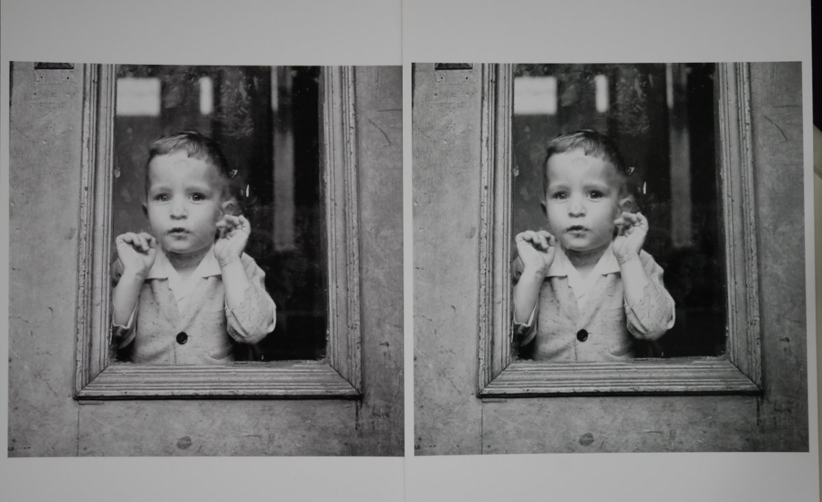

That was my first impression too .. but it is really a matter of relativity, the left side could appear a bit magenta, similar to the diluted ink.
(edit) in several pdf's about making b&w ink sets paul roark says, the noritsu black dye ink would have a greenish tint. This is interesting because noritsu dye ink for drylabs could be the equivalent to the fuji frontier DL ink...

As long as we all look to those test images on our monitors we all will see something different, some are
probably not calibrated, and don't have a common white point either. The black levels should be measured with a spectrophotometer. If a RGB 0,0, 0 black is printed and looks like having a tint, you won't be able to correct that with an ICC profile, you would need a RIP to control the color channels independently and/or to correct the black level tint. Looking to those diluted colors ist just a comparison against each other, that works better on a monitor. I somehow remember some experiment quite some time ago, but cannot find a link anymore, o.k., somebody was trying to get a better black level, by overprinting the blacks with black again. You cannot do that with a normal printer in a second pass, the paper positioning accuracy is just not good enough for that, but good enough for a try, print a black square, and overprint that with a smaller square in a second pass , and under good illmination you'll recognize the overrprinted area being darker.
The experiment was to tweak a RIP for a Epson 4800 printer to reassign the black and gray channels to 2x black and 1x light black to achieve the overprint in one pass. There was some improvement seen from that experiment but it is apparently not good enough to convince many.

Okay, the color that you see in the one-drop-dilution is certainly not the color of the same black printed on paper ... but it is definitely in the ink, no optical effect. Just take a look at post 49!
I'm not the first who noticed a violet tint of many dye blacks - and a surprising neutral tint of the claria black.
How a certain black will look on a print is another question, because the second factor is the paper.
For example see p 3-4 of this pdf from Paul Roark, where he adds magenta to the DL black to compensate the printing on some sort of papers:
http://www.paulroark.com/BW-Info/BW-Dye.pdf
My prints in posting 58 and 60 are showing exactly this (very slight) color tint of black. They are printed with r285 in "black only mode" (using only the black ink channel) and comparing coralgraph with fuji DL (which is obviously pretty much the same as claria).
BTW I came to the "one drop dilution", because I wanted to estimate the density of normal and light inks. Took each 30ml of one-drop C and LC (of different sets), then diluted the C more, step by step, until it looked like LC. So I got a roughly estimated ratio for diluting my DL C+M to LC+LM. Besides I got helpful information here in the forum and from Paul Roark's site.
