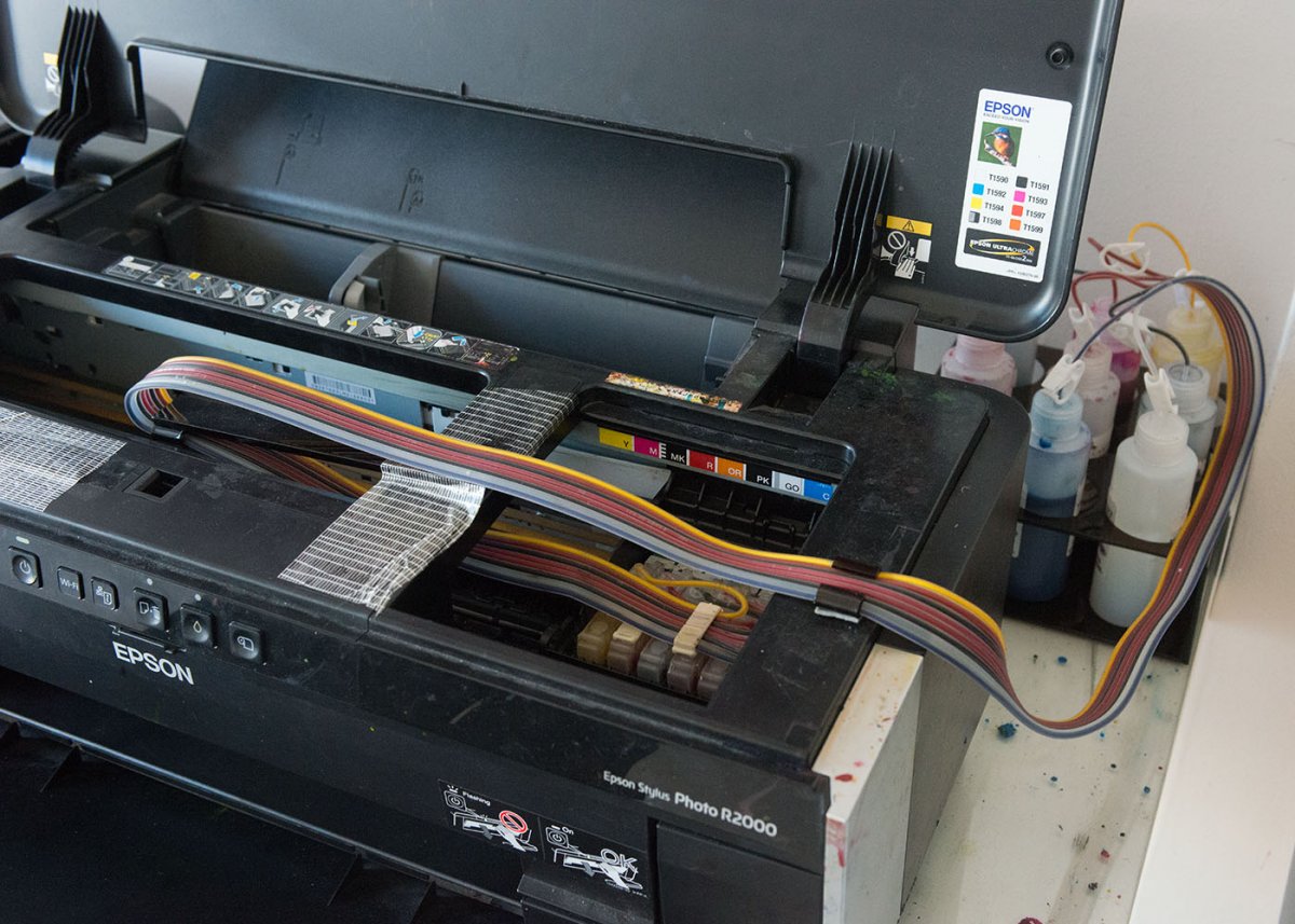

Here's a picture:
If this is indeed related to the tubes flexing, shouldn't it happen during the whole length of the print? If I print an 80cm long image for example, it only happens for the first few inches, the rest is perfect...
I think your ink ribbon support is upside down as I've always had the ribbon holding slot on the top for the best smoothest operation. If it was flipped 180 degrees you would have a smother transition as the head went from left to right. Any roughness of travel due to constrictions of the riboon and it will cause all sorts of printing artifacts.
By the way, how is the resetting of the chips behaving? You have two push buttons right? Each button resetting 4 colors.
I had a similar system from the same company on of my R1900 and the chip reset process never worked and I think I know what I am doing. It locked up my printer with errors and I thought the printer was a goner. But after removing it and installing a full set of OEM carts all was fine again. Never went back to the IJC CISS. Hopefully they have improved the reset process on the R2000 CISS.
Joe
The problem was resolved after running a Bi-D adjustment using the service program, so tubing wasn't causing this. I'm not sure how I could flip the tubes 180 degrees though, as they come from the right of the printer and reach the carriage from its left side. Turning them the other way round would cause them to twist one more time during the movement of the carriage than they do now.
As it turns out, there are two kinds of chip for the R2000. The ones I got from cityink can be reset at any time, whereas those I got with the CISS from inkjetcarts can only be reset when one of the four reaches the empty state. In both cases, the chips have to be reset while the carriage is on the cartridge change position, resetting them at any other time, even when the printer is off, results in errors following that or when turned back on.
The advantage of the first system is that you can reset all 8 once one of them goes empty. With the second system, you are having twice as much reset cycles, sometimes in close succession.

Weird. I thought IJC chip bank was "Reset All to Full". It was for the R1900.
