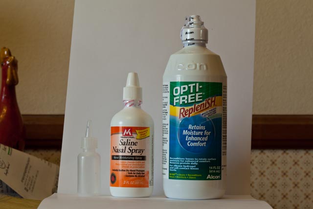

Something I'm pondering ... with the plastic ball removed from the CLI-8 inlet port, I wonder if a needle is needed, or if a needle is not needed (say that three times quickly ... <g>). I suspect a larger version of R-Jet Tek's #1944 inflator bottle would suffice to get the ink into the reservoir.

Thanks for the input. At some point I'll probably try a squeeze bottle, and then no doubt realize the error of my ways.
But before that, I anticipate investigating a needle-free refill method through the inlet port. I think common bottles I already have may be worth trying.
