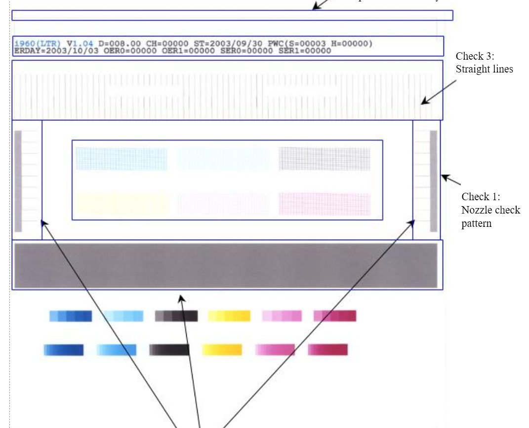

You have to knew that the most consumer Canon printers do have 2 - 3 nozzle rows for particular color channel. These rows are different in color intensity or in droplet size. Smaller a droplet the lighter color.
Ahhh...most Canon consumer photo printers do NOT have "different sized" nozzles for the same color. They are all the same size (Pigment Black nozzles are typically larger and fewer than color nozzles, but they are use for text/line graphics, only on plain paper). That said, some Canon inkjets might have different sized nozzles, but I'm not aware of any consumer (home) printers that do.
The real test? A service test print (with the printed grids, not pastel blocks)! If there were different sized nozzles for any color, then there would be TWO grids for any color using TWO nozzles sizes, to fully reveal any "large" or "small" nozzle issues.
Some Epson Printers appear to have nozzle check prints that exhibit this behavior (two grids per color)...

Good point, however that's not a service test print. Here's a sample from a six color i960 (from the service manual).

...and from an 8 color i9900.
As you probably knew Epson has variable inkjet droplet technology: That means changing piezo impulse it can change inkjet droplet size
Canon and HP cannot do that. Canon has developed fix droplet size LSI technology. And as you can see it can be scaled up to two or three channels for the same color.
In your case you have dedicated LC and LM for better image quality. I do not knew what is particular droplet size for these channels but I do suppose it is by far bigger than the third light channel on this particular consumer print head. Something like ratio 9 vs 6 vs 3 or 8 vs 4 vs 2

A service test print from one of those printers will be a definitive answer..
