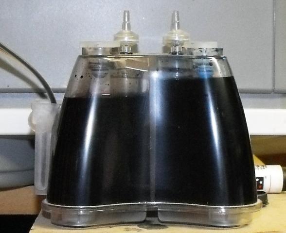

But there are several thing you’ll have to watch out for, the standard CISS setup bottles are like this
(Bottom feed)

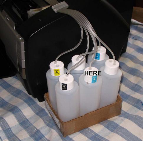

but they won’t work that good at all when using pigment ink, you’ll need a setup like this to give you much better control over your ink.
(Top feed)
To get the pigment ink working properly in the CISS bottles you’ll need to agitate the CISS bottles for at least ten second about every two days to keep the pigment suspended in it’s solution and print at least once a week to maintain your printer in good working condition.

the concern is that pigment inks may settle down and clog the ink system, the tubes from the ink reservoirs are at the bottom just there where the sediment would settle. I don't think the problem is that big, but awareness and care is always recommended. You can do one thing with the Epson CISS, when you are finished with printing you can lay the the ink reservoir flat, and when you start printing again, you shake it a little bit and bring it into the normal working position again. All this is not a problem when you print frequently, daily, but usage patterns of people vary very much, and some let the printer idle for days and weeks. Water as a cleaning agent is not recommended, I just can tell you from my experience that I saw problems/ reactions between inks with yellow inks several times in the past, not always, but if you are not prepared for it it's too late. I do something else, I take a few ml of both inks , put them into a glass and let it settle and if it is flocking out, you will see it after a while at the bottom. It's visible with yellow inks, but not with the others, they are not translucent enough. Any printhead flushing/cleaning solution should do.
