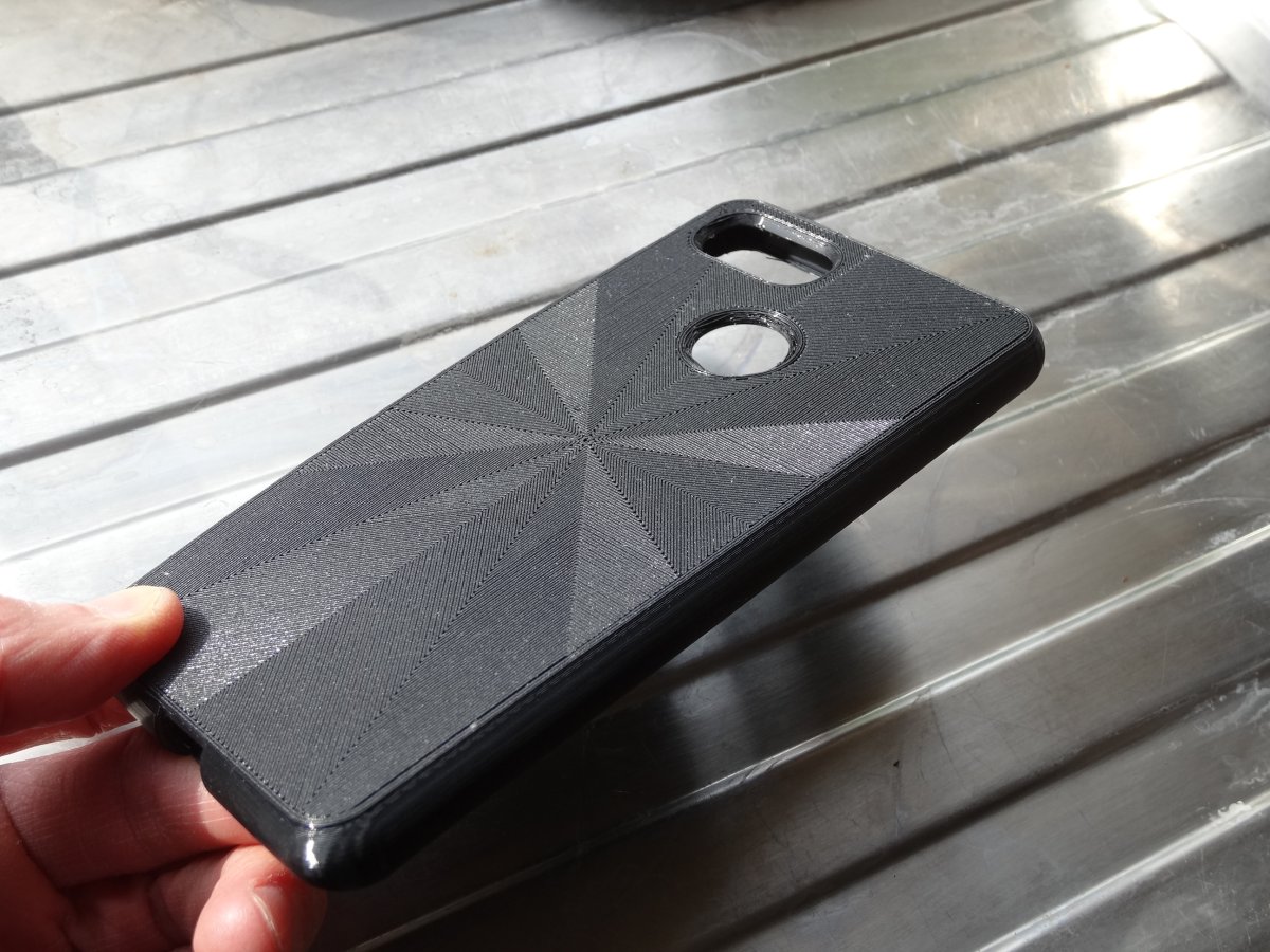

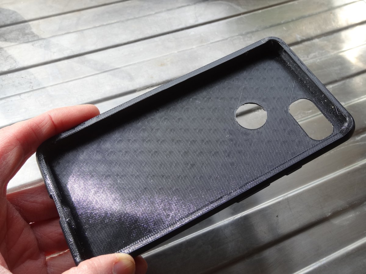

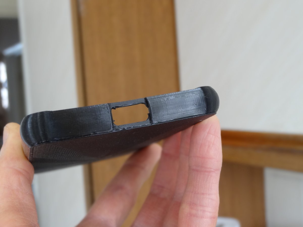

I just printed this phone case on my Ender 3 pro (standard Bowden setup) in Sunlu TPU. Bridging and overhangs worked out quite well. Took about 7 hours at 15mm/s. Sliced with SuperSlicer, 2.5mm retraction, and using pressure advance and Klipper firmware.

I don't know how much Klipper/pressure advance helps but I think at these very slow speeds not much - so I reckon you'll be ok (and you can use linear advance in Marlin in case that helps). I'm just using the standard plastic extruder, bowden tube and hotend. It works perfectly at 15mm/s but I'm resisting the temptation to go faster.
