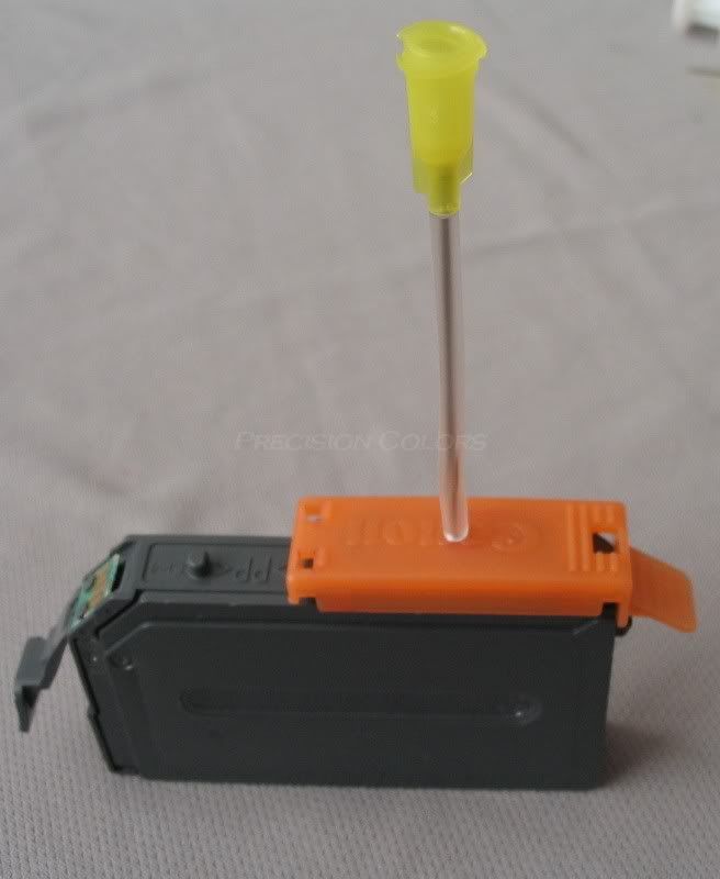

The Hat ReFilling Method Mark ll for PGI-9 Cartridge.
mikling
Jul 2, 2006
3,239
1,472
Toronto, Canada
The needle is shortened so that it does not contact the pad or protrude beyond the rubber pad.
The rubber pad provides an air tight seal that will allow perfect sealing.
