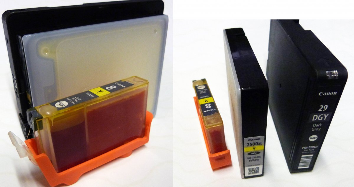

be Here is the all new 2500 cart for the Maxify beside a CLI-8 and PGI 29 cart, it can take anywhere between 18 to 24 ml. depending on which you use.

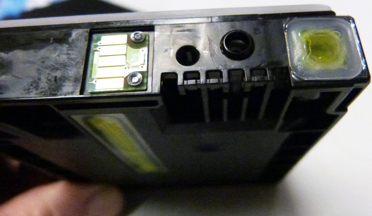

This shows the new large chip, the next hole is just for centring the cart when fitting, the raised hole is used for detecting the ink levels (Sort of Prism) and the last one is the ink outlet itself. (Very cheaply constructed)

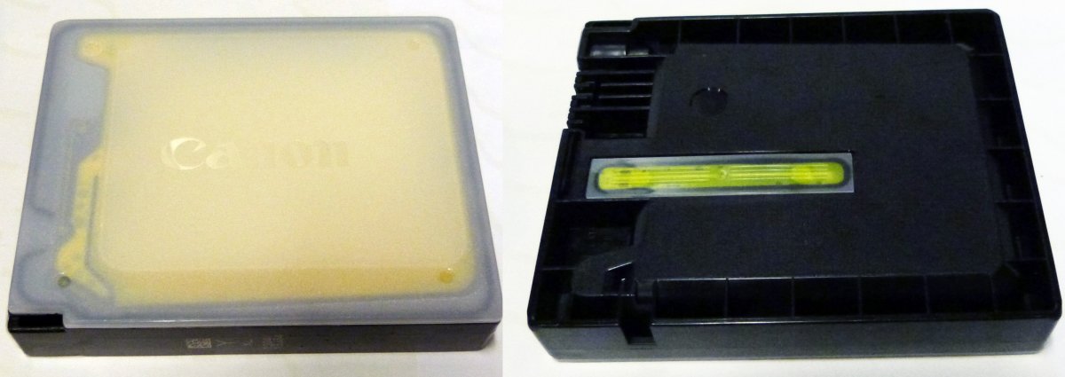

Here is one side of the cart which is a semi opaque while the other shows the crazy new ink system for detecting low or out of ink in the cart.

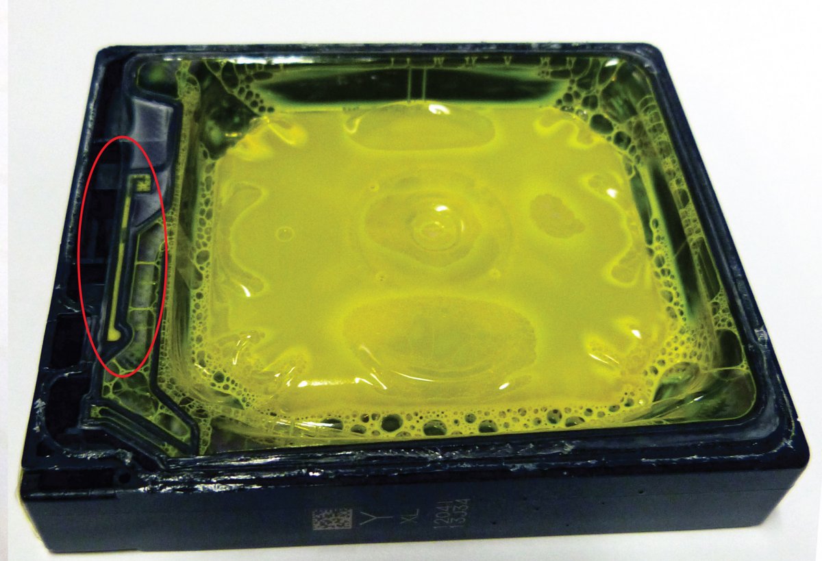

Here I have the cover off the cart to show the inner plastic bag and also marked the ink channel that replaces the old prism that was on the CLI-8’s.

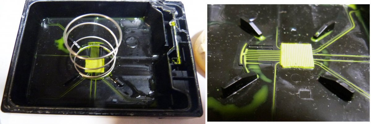

This one shows the plastic bag cut away and the spring for keeping the bag inflated at all times, please note the small metal mesh with strange groves leading up to it, this is where the ink enters/exits the detection system for indicating low ink.
These carts are very easy to fill, in fact to easy but whether the cart will work again in the printer is anybody’s guess because the anti-refill system (Prism) is sealed and once the ink level drops below this then air enters and cannot be removed later.
