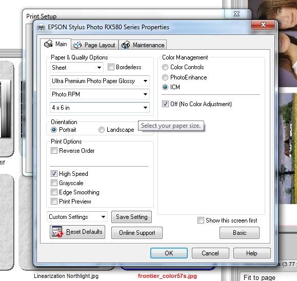

Then we turn off Color Management within the driver by checking OFF (No Color Adjustment)

Now notice the dropdown window I have intentionally brought up when I click on the PhotoRPM selection.
In this area we are able to sometimes further choose the resolution settings. In this case the PhotoRPM is selected by default. On other models, Best Photo is selected by default and we will need to change it to PhotoRPM by further selecting it.
This selection is important within the driver as well with respect to profiles. Some profiles can be used both with Best Photo and Photo RPM and some profiles are made specific to what the profile was created with.
We then click on OK and then OK again and we are now back in the Qimage workspace.

In the above instance by selecting the profile within Qimage, we have Qimage managing color and we then turned OFF ( No Color Adjustment) color management within the driver. That means that color is managed at ONE level alone. If we had not turned OFF the color adjustment withing the driver, then we would have managed color at two levels and the colors printed would be dark and look very wrong. This is sometimes referred to as double color managed and is a frequent error by those attempting to print with color management.
