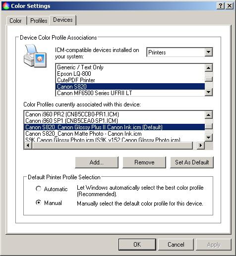

It associates any number of profiles to a specific device within a device class and lets you set a default. When looking at an application you'll get the list of profiles that you can select from. I put in the profile name when I create it the paper and ink used.

You will need to test whether this method provides the same output as that produced by properly color managed programs like Adobe Photoshop, Lightroom etc. My experience after many tries years ago is that it does not produce the same results. I could be wrong but, there are things like color space and rendering intent that this applet did not have at least when I tried it many years ago. Additionally even some programs like ACDSEE products that I had tried color management with output pictures that are different from Adobe products and Qimgae. For this reason, I did not include instructions for ACDSEE until I figure out what the peculiarity is and had given up for years.... right now I have abandoned print functions with ACSsee. A search about ACDSEE and color management has many other users also experiencing difficulties as well so either we all doing something wrong or there is something there that is indeed odd or tricky.

The association of profiles and printers in this microsoft tool seems to be exactly the same as you have in the normal windows control panel of printers:
- "let windows .." or - "manually select.."
Problem is that you can manually associate only one profile at a time. And it is annoying to change the profile in the setting every time you change the paper. This should to be changeable in the menu / driver of the printer!
But it is nice to see the gamut of the different DIY profiles and compare them with others...

You can only associate one default profile. You can associate multiple profiles per device and in many color management applications for that device is the list that appears in the dropdown for that printer. Mine will be not just for the paper type but for the non-OEM ink I'll be going to.
The Canon driver I have does not let me choose select the icm so at first I did have to select a default this way. I now use QImage Pro to drive the printer:
http://www.ddisoftware.com/qimage/editions.htm
as my editor does soft proofing but will not color manage the printer like Photoshop offers. If I chose to use in this old S820 driver to enable .icm all colors in contrast and saturation were off. A Canon tech advised this feature was not functional.
I acquired a Color Munki to create profiles for this printer. and colors and luminance with soft proofing are very close now to the hard copy.
