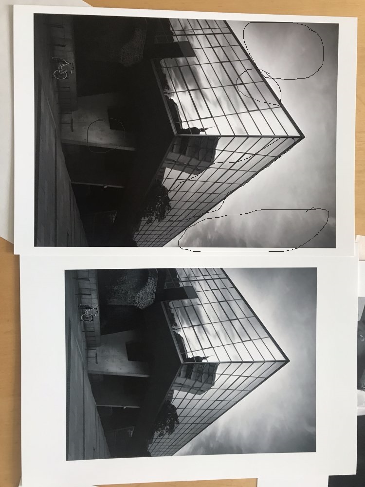

Took a look at your first posted image and see Magenta highlights in various places in the top image. The Black circles roughly represent where I see Magenta. Even the Blue image has Magenta highlights in the sky though significantly less than the top image.
True, my initial prints had a slight magenta cast depending on the paper I chose, but nothing too serious.
The current prints do not have this magenta cast, it only appears that way due to the cheap flatbed scanner I used
