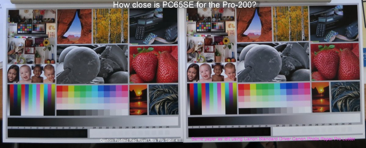

Catching up a bit now.
"Closer comparison" to what? You did not properly label your images again. Your aftermarket ink with a custom ICC on Red River paper vs ??? ink on Red River paper using a Canon ICC, not a custom ICC for the ink-paper-printer combination?
Red River does have custom printer profiles for the Canon pro-200 and OEM Canon ink, so you could have done more an apples to apples comparison with the aftermarket paper.
https://www.redrivercatalog.com/profiles/canon-pro-200-icc-printer-color-profiles.html
Unless you are using an ICC designed for the ink-paper-printer then your comparison is nice but of indeterminate value in judging how it performs against OEM ink with a proper ICC printer profile. You know this. You make your own ICC printer profiles.
I reckon the one on the left looks better than the one on the right, there is a slight difference in its favour, but without proper ink monitoring it will be useless, because we’ll save money on the 3rd party inks but waste it on new print heads.. You’ll need more input to achieve the holy Grail.... Don’t give up.. :thumbsup

If you can get better, there is a$1000 on the line,.

If you can get better, Like I said, there is a $1000 on the table for you.
Make sure your bank account is up to snuff.
All we get are the armchair critics, well show me better. $1000 is a lot of money. Put up or shut up.

the left part of the image is printed on a Red River Ultra Pro Satin 4 with a custom profile for a PC65SE inkset printed on a Pro-200, the right print is done on the same paper using the profile for the Canon Photo Paper Pro Luster (with the Canon inkset or the PC65SE inkset ?), both prints look pretty similar to me, with the same color balance, but I won't go and read color variances from the screen, and I would not try to print a paper with a profile for a different paper in the first place, this may work in this case, but not in other cases - e.g. with a Satin paper by another company.
It’s all meant to be smoke and mirrors just to get the publicity and ain’t I a great guy for giving you all a poorer alternative to OEM at not such a knock down price, bottle OEM ink may be a more appropriate.. We’ll see..
