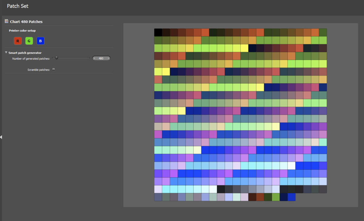

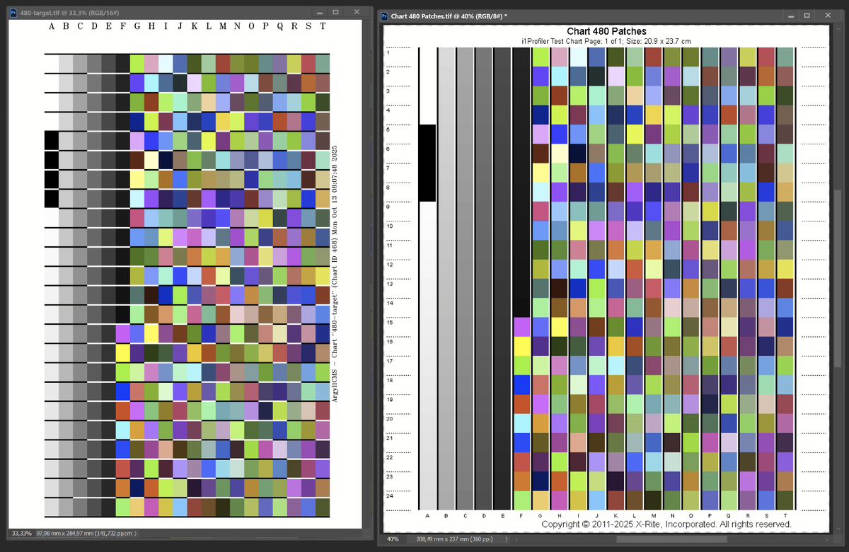

I have generate a ti1 file and used ArgyllCMS to generate a ti2 and a corresponding tif file: 20 rows with 24 patches non-randomized and also loaded the AI generated pxf file in i1Profiler and generated the target with some fiddling in the patch size in order to get a corresponding target that looks the same: 24 rows with 20 patches and this is the result side by side:
left: ArgyllCMS generated tif-file and right: i1Profiler optimized target (to get 24 rows with 20 patches):

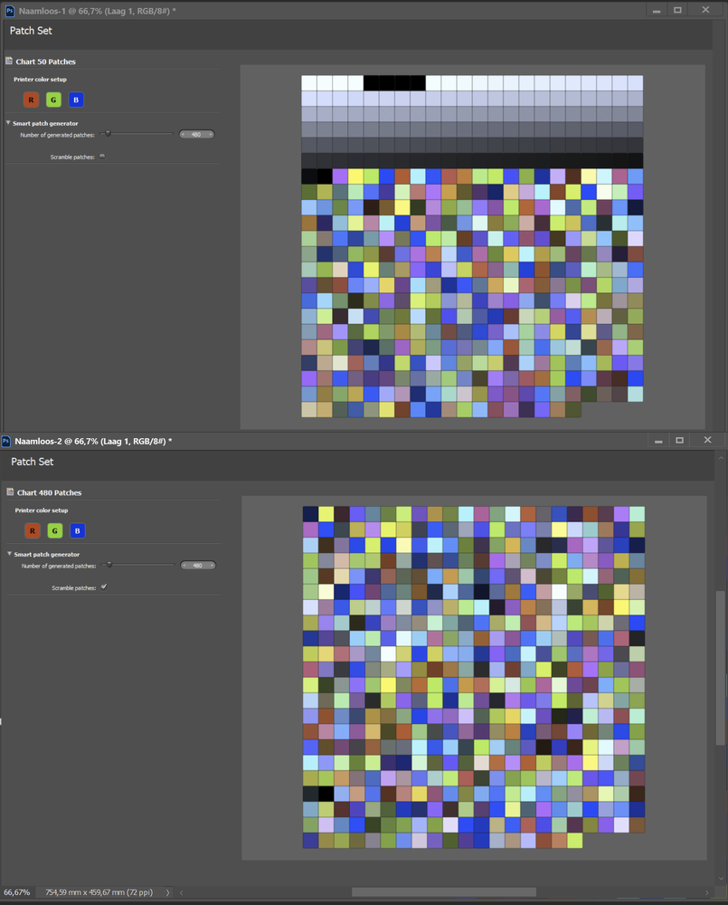

You can see the AI script does it work. NOTE: DO NOT choose scramble when loading the pxf file in i1Profiler, because it does not scramble but uses new patches based on the patch generator of i1Profiler, so you will loose the chosen: patches:
The scramble button above checked does not scramble the 480-patch target with 128 grey steps, but instead will use their own generator to create new patches: when you uncheck the scramble butto again this is what you get:
your original 480-target patches with 128 grey steps are GONE !!! DO NOT USE the scramble button in i1Profiler if you want to maintain the ti1 generated patches.

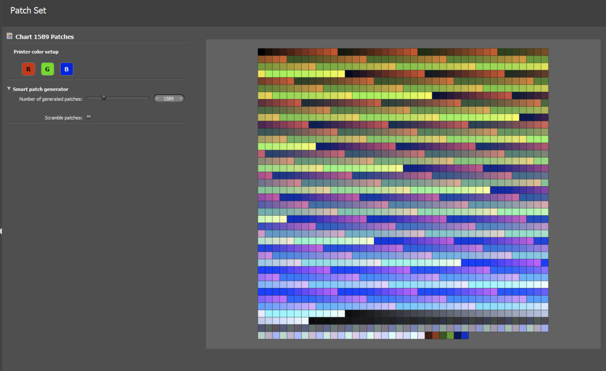

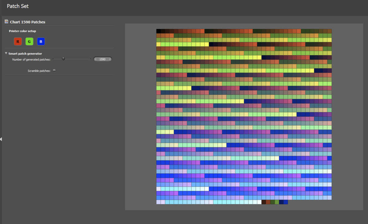

The strange behavior of i1Profiler in the amount of grey and near neutral patch generating
If you choose 1589 patches: alot of grey steps and near neutral steps:
But when you add 1 extra patch (total: 1590) the grey steps and near neutral steps are GONE:
This is the reason I prefer ArgyllCMS in patch generating, because you can fix the amount of grey steps at a given patch count.
