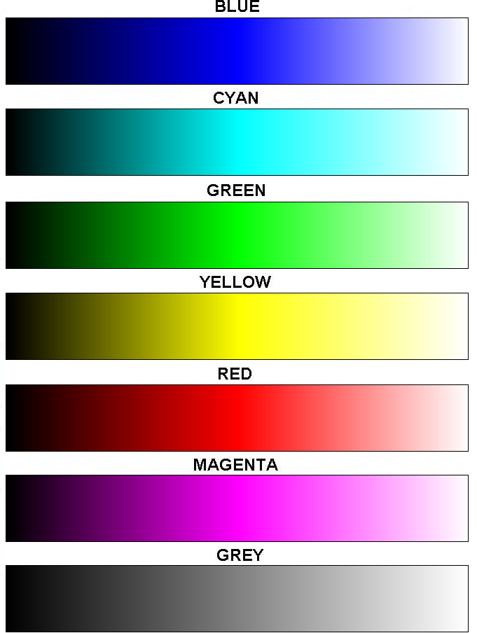

This discussion was/is interesting but faded away without real conclusions. I am inclined toward Stratman's view and would say treat the profiling target as you intend to treat/view the print. That is, leave the profile target print to fully dry until it is stable. The intervening undried ink state is not relevant.
I picked up on these posts while looking for more on the 1315 color_test_image.png file. I was finding that the colour strips as printed were not reaching full white. The starts were darkened by a greyish haze rather than deeper colour. Banding in the mid to dark colours was noticeable in some colours but less obvious when fully dried. This description sounds as though the printer did a terrible job, but in normal use it produces excellent results. So clearly this is a stiff test. Before commenting might I suggest you try printing the file on your own printer!!
The results are all influenced by profile, intent, paper, ink and printer.
