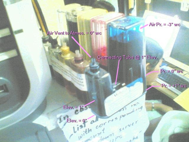

Narmenia,
So glad you took and posted pictures. Now I can confirm that your CIS is the first commercial one that I have seen that can really control ink pressure.
Set up as shown, (and as you are instructed), the ink level is constant, but much lower than it has to be, with the result that the negative pressure of the delivered ink is greater than it has to be. The down side of the greater negative pressure is the increased chance of leakage at the cartridge seal, and the more work for the printhead in pumping up the ink.
I have stuck notes on one of your pictures to indicate the elevations and the pressures that will exist.
The "Air Pr. = -3"wc" indicates the negative pressure that hold up the ink in the cyan tank. The pressure will depend on the amount of ink in the main tank. If the ink is 1" lower, the air pressure will be at -2" water column, etc.
As ink is consumed, the ink level in the short tank will drop below 1" and a bit of air will be allowed to pass through the connecting tube into the main tank, letting its ink level drop, refilling the short tank back to its normal 1" level.
Your CIS does operate as I was thinking, and uses a form of Mariottes Bottle to keep the ink level in the shorter tank constant at about 1" elevation. The resulting pressure, where the tubing connects at the bottom of the main bottle, is +1" water column. The pressure in the ink tube going to the cartridge will be negative by the elevation difference between the table and the cartridge exit port/printhead ink input. I believe the iP4300 has the cartridge exit at about 3.6" higher than the table. This leaves the present ink pressure at -3.6" +1" = -2.6" water column. I would consider raising the ink tanks by 1.5", leaving the delivered ink pressure at -1.1" water column. The printhead is intended to operate at a negative pressure, and 1" or so is plenty.
With all that said, your problem may still be from some other cause. We won't know until you try some things. Pay attention to Websnail's comment about the extra cleaning and/or printing needed to clear some things up. I have seen an overpressure situation require a half page of single color purge to clear all the streaks out.

I don't have the information needed to recommend the height for your other printers, however, you can figure out the height.
The object is to have the elevation of the ink in the short tanks be about 1 inch below the bottom of the cartridges in the printer. This means that for your CIS, the bottom of the ink tanks should be about 2 inches below the bottom of the cartridges.
It may take several measurements to determine the elevation of the cartridge bottoms in the printer. You want to learn how high the cartridge bottom is above the printer table or shelf. I would measure from the cartridge bottom up to the top of the printer, and then measure the distance from the table or shelf up to the top of the printer. The difference between the two measurements is obviously the height of the cartridge bottom above the table or shelf. Now, arrange the CIS tank bottom to be about 2 inches lower than that height.
