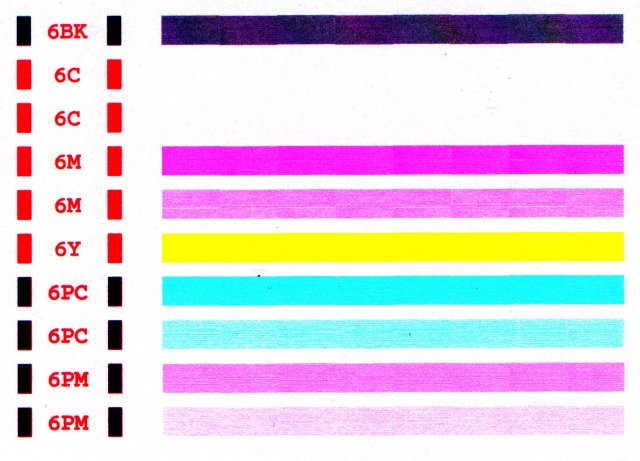

Sorry I wasnt clear enough about nozzle check pattern. I am posting a scan that I hope comes through clear enough. The odd colors are in what I guess you would call titles at the start of each color bar. Then the only thing off in the bars is the missing bars for the cyan.
In rechecking by removing carts. & head and blotting the nozzles with a tissue found excess magenta. My conclusion is that I had a leaker. This was changed before doing the cleaning listed below and made NO DIFFERENCE in any of the checks.
Before hearing from any of you I have done what I understood this http://www.nifty-stuff.com/forum/viewtopic.php?id=2990 procedure to be putting some generic (Windex like) glass cleaner in all slots. But, see now that in doing this part If you find that you have some stubborn nozzles and you want to give up for the day, put Windex on the pads, close the cover so that the head parks, pull the plug on the printer and let it sit that way until the next time you are ready to try again. Oftentimes, that will be enough to unclog the remaining nozzles
I should have had the head in the park position when pulling the plug for the night. I did have the carts removed and capped with the orange ones that come with the Canon carts held on with rubber bands. It did not do the trick and I still get the same nozzle check.

Have you removed your printhead since the nozzle checks at the beginning of this thread when the cyan was printing?
It looks like your cyan is not printing at all. This is not a normal nozzle clog problem. It is probably an electrical problem, either in the printhead or in the printer, unless you have a totally clogged cartridge. Can you try another cartridge? If you don't have another cyan, swap your photo cyan with your cyan and see if the problem switches. Power cycle your printer and then don't print anything except nozzle checks.

I did a search for more cleaning information (which was not as fruitful as I hoped most search engines dont seem to expect thing phrased the way that is natural for me). By going through the steps described at post #4 in the thread here http://www.nifty-stuff.com/forum/viewtopic.php?id=2926, earlier in this one and elsewhere I seemed to be making good headway. I left it after a fresh dose of cleaner on the parking pad and the nozzles with the head in the park position. Then this morning took the head out and wiped off excess cleaning fluid; put cartridges back in and kept getting better and better nozzle checks. The light bar from the PC was slightly lighter than I thought it might be but there! Others were as expected.
I then went to printing the photos I had planned on daysssss ago. Each sheet consisted of 3 photos at 4" x 6" on a 8.5" x11" (US letter size) sheet of matte photo paper. This was not constant printing as a sheet of 3 would be set up, printed, those 3 cleared and the next three set up. I went through 12 sheets that were just fine. And then on the 13th sheet (of all sheets!) saw a strong GREEN cast to everything as it started coming out. I canceled the printing, did a nozzle check which showed a lack of PM bars. In checking the actual cartridges found the PM tank side looking like something that had been shaken with bubbles at the top.

The green cast on your 13th photo is consistent with the PM not printing during a nozzle check. However, the bubbles in the tank side of you PM cartridge is normal for a cartridge delivering ink. However, as Tin Ho suggested in post #8 of this thread (and others on other threads) the lack of printing can also be caused by too much ink flooding the nozzles. Apparently this can happen with off-brand cartridges or incorrectly refilled Canon cartridges. Another thing that can happen is there can be a coating of dried ink on the bottom of the nozzles preventing them from printing. My cleaning process will solve this problem.
Maybe you should purcase a new Canon PM cartridge to see if that solves your problem. I suggest you get one and make sure the nozzle check shows all nozzles working correctly before proceeding. Follow my process for cleaning until the nozzle check works.

Yes, I should have said I was not surprised to find a PM or M missing after the green print.
This morning the bubbles in the PM were down and I found nothing that looked out of place on the bottom of the head (nozzles). I did a nozzle check that came out fine. So I took a chance and ran the final page with three 4 x 6 photos on it that finishes one project. That sheet turned out fine.
