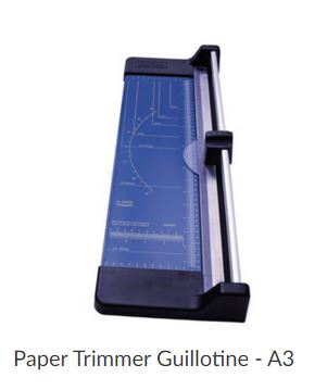

Print with a border gives you much better quality and a few minutes spent trimming the edges results in the same finish without compromising your printer..
View attachment 12732 click to enlarge..
