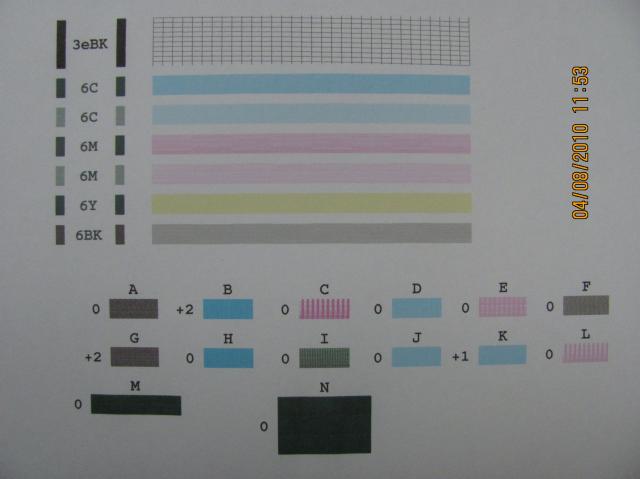

I took a quick picture, it is a bit dark but shows clearly the problem.
Many thanks for your help.

Your picture is very difficult to scrutinize so let me ask you some questions about it:
It looks like there are three light horizontal stripes in the first part of the dark magenta bar and then two light horizontal stripes in the second part and then this pattern repeats three more times. Is this correct?
It also looks like the light magental bar has an identical pattern of light stripes. Is this correct?
Do the light stripes have any magenta in them or are they pure white?
Can you take a sharp closeup of these first two patterns on the dark and light magenta and upload it?

Yes, it is as you mentioned, I have taken another shot but with artificial lighting is not better, however, I have uploaded on another site where I am allowed the full size, so it is much better for you to see.
I tried the ammonia in the meantime, no change.

It appears that you have some clogged nozzles. I would simply do a nozzle check once a day, leaving power on all the time. Sometimes, it just takes time for clogs like this to dissolve. If you want, you can put some Windex on the purge pads after each nozzle check but I wouldn't try any other solvents or remove the print head from the printer. See if there is any improvement after a week.
Do you still have your other clogged print heads?
