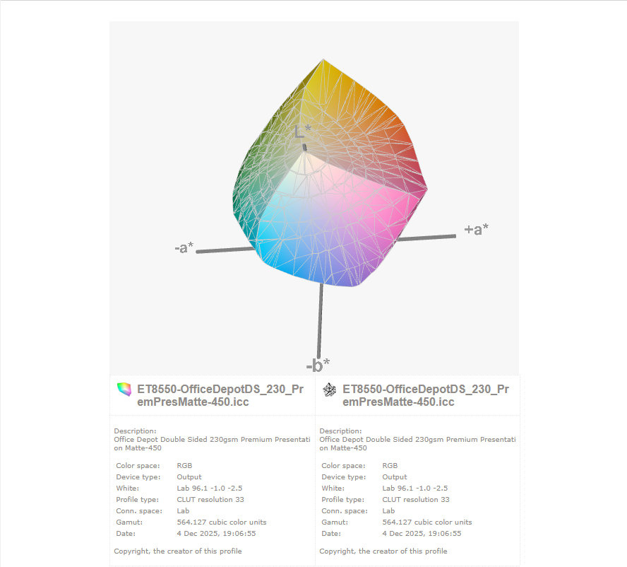

Long time listener, first time caller. I tweaked the batch files in Epatcola's AWK scripts to generate 10mm patches using -a1.25 and set it to create 25 patch columns on letter-sized paper. Made it WAY easier to scan patches for me after trying repeatedly with 8mm patches. I was able to fit 450 patches on one sheet of letter, and it resulted in a profiles that I'm honestly VERY happy with. I was getting a lot of jaggy edges on the visualization for the 300x8mm patch scans.
