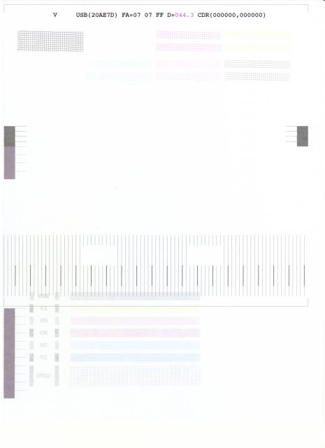

I have been working on a friend's MP780 and it displays the extended nozzle check the same as my MP760 but differently than the one posted above in post #20. But in any case, I am positive that there are missing grid patterns. There should be three columns of the small grid patterns, not two. Also, if your cyan were working correctly, you would see a version number at the top just after the "V".
I would suggest that you do a regular nozzle check, open the cover, put some Windex on the purge pads, close the cover, wait for activity to stop, and then pull the power cord out of the back of the printer. Leave it this way overnight or at least many hours. Plug it back in and do another extended nozzle check to see if you can get that first column of small grids to print. If you cannot after several repeated attempts, you will need to get a new print head to get your printer working correctly again.

I did as you suggested. I do have three columns of colored grids, but the cyan column is missing the top two grids and there is no cyan accross the top where the version number should be. I'm going to try the recommended cleaning process a few more times.

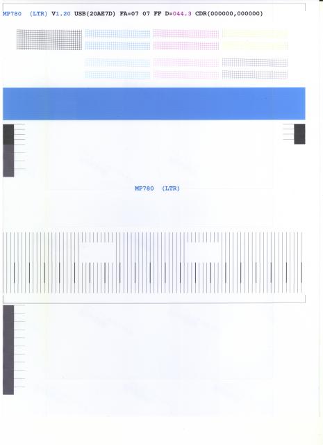

I uploaded an image of the extended nozzle check from my friend's MP780 and added to the thread linked in post #19 and repeated below for convenience. I'm still concerned/confused/amazed that your extended nozzle check shows colors in a different pattern. Could you upload your latest extended nozzle check that shows the three columns of colored grids? I cannot see that on your previous upload.

The first image is the one I ran this morning after soaking the purge pad overnight with Windex. The second image I just ran after applying some Windex to the screen under the cyan cartridge.

It looks like success.
You're going to have to help me with the colors on your last extended nozzle check image: Of the three columns of small grids, is the first one cyan, the second one magenta and the third one yellow and black? Can you see a significant difference in the colors of the second column compared to the image in post #20? If so, how do you account for that?
Also the big block of color under the grids: what color is it? It looks very dark to me compared to my friend's. Is it cyan or does it have magenta mixed in with it?

The first column is cyan, the second, magenta, the third yellow and black.
The image in post #20-I believe I ran the wrong extended nozzle check pattern. It was probably SHUKKEN PATTERN 1.
The big block of color is cyan. It really looks just like the image you posted.
