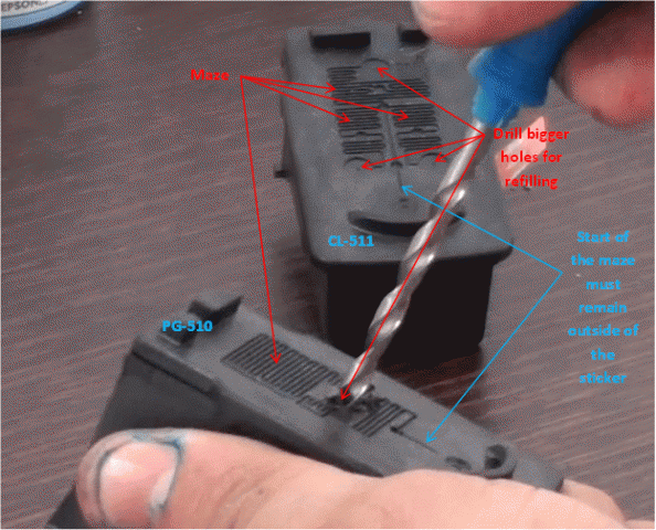

Thanks for the replies guys. Some things Im not so sure about. you can carefully peel off the label and notice that the maze leads to indentations on the cartridge. Sorry, what maze exactly.
I havent bought this printer yet maybe I should go for a previous modelIm not even sure if suitable ink is available for it yet. The instructions look a little too Hit n Miss for comfort. Has anybody had success using this method (without using stoppers i.e.peeling off label) to actually refill the above cartridges?
Here is a picture of PG510 and CL511 (your cartridges will look like this, even if they are different code) with the stickers removed:
<-- click to enlarge
The drill used in the above picture is big in diameter as these cartridges were prepared for ciss. For refilling you could use a smaller diameter drill.

I bought the InkTec kits and refilled following the instructions (almost):
refill PG-510,512: http://www.youtube.com/watch?v=_-1M2Fg1WRE&feature=player_embedded
refill CL-511,513: http://www.youtube.com/watch?v=F8RyCuW6dy0&feature=player_embedded
What I did different is I drilled the holes with a 4mm drill so I could see the sponge when I refill. I inject ink slowly till I see the sponge saturated with ink, then I take the needle out, put it in the sponge just 3-4mm and suck out about 0,5ml for color and 1ml for black. Then I follow the instructions: put the cartridge in the holder and suck out slowly through the nozzles about 1ml of ink. The label goes back on the cartridge. I put the cartridges in the printer, initialize a head cleaning followed by a nozzle check. If everything is ok I resume printing, if not I do another head cleaning.
