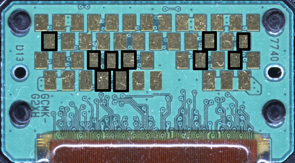

@Harvey
If it is fraud, then printhead is likely to have sealed (or in any way disabled) certain contacts on printhead connector:

@Harvey
Ł.
These contacts marked are not the ones I masked in my QY6-0073. Now the printer only uses pigment black and there is no more B200 error.
I know that :)
Picture posted before was to show contacts sealing which will result in nozzle print posted in first post:

I know that :)
_57-jpg.2332
Ł.
So you say that if the contacts marked are sealed I will end up getting the same nozzle check pattern as the one I uploaded_? I masked mine according to I guess one of your posts and only PGBK grid pattern shows in the nozzle check print.
