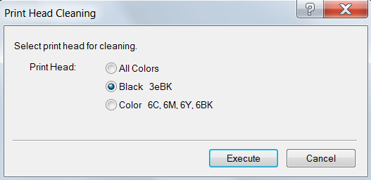

no printing on mp520 canon pixma

I reckon at some point you must have run out of ink and continued to print and that is a death Nell for the print head in any Canon printer, the heads overheat when there is no ink passing through the nozzles causing them to burn out.
You will have no alternative but to get a new print head if you wish to use your printer fully again, but you can continue to print successfully if you set your Media setting to "Matte paper", it will take a bit longer for text to print and it wont be highlighter proof either, sorry..

If all colors (or the text black) stops printing i.e prints absolutely nothing "out of the blue", I would think of an electrical problem. Seems to happen quite frequently with canon bubble jets... Clogging used to make stripes first.
You can do the "stamp test":
Let the printer do a cleaning cycle (of all colors) then take out the printhead and press it gently on a paper towel.
If there is ink (usually 4 rows of photo colors and one bigger row of text black) the problem is probably electrical, chip/logic board of printhead or printer.
If there is no ink (or no text black) then it might be the purging unit... or whatever..

For cleaning I was just using the control panel on the printer, not computer software. I just found the Mac version of that screen shot and tried again. No luck. Printing with "matte photo paper" option seems to work.
