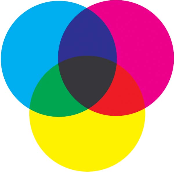

I would add a 4th drawback to using C/M/Y to print Black It will not print anywhere near as dark as a printer using black ink.
Open this spreadsheet, click on the OEM Inks sheet and look at the Canon CLI-8 C/M/Y Inks graph. Because inks absorb light, a low value means that light at this wavelength will be absorbed by the ink and wont be reflected by the paper. Conversely, a high value means that the ink does not absorb this wavelength of light and it will be reflected by the paper. Note that there are some wavelengths where light is almost completely absorbed (e.g. 22-26 the actual wavelengths corresponding to these values are given in Column B of the spreadsheet), but there are many other wavelengths where the combination of all 3 inks is not as good.
Click on the Black sheet to see the absorption curves for black ink It is easy to see that the OEM CLI-8 black will appear to be the blackest of all of the inks that were tested.
Here is an image generated in the CMYK color space in Photoshop, with intersecting circles of C/M/Y. It was then converted back to RGB. The intersection of the 3 circles is a simulation of a combination of C, M and Y inks it is far from a deep black. This is why photo black is added to printers designed mainly to print photos. Your eyes will adjust to the lighter D max when viewed in isolation, but a side by side comparison of a CMYK and a CMY print will show a large difference in the dark tones.
