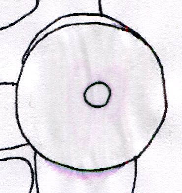

I was too quick to say the Canon pigment ink doesn't smear. This is after a few minutes. Maybe this is caused by adding cyan and magenta dye ink to get a more perfect/neutral black. I'll do more testing to find out what's going on. B/W copying might be a solution.
Here is the smear test using five drops of "pharmacist's cleaning fluid" applied in the centre spot:

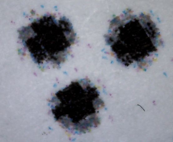

Edit: the printer does add colour dye ink to the print, see this 50 X magnification of dots from the lady's dress:

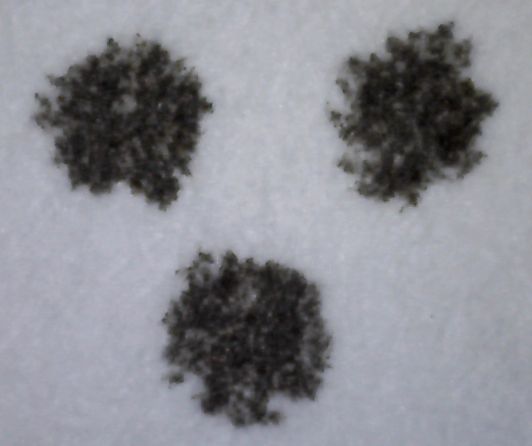

Making a B/W copy of the print using a Canon MP800 with plain paper setting results in a print with only pigment black, no dye ink added:
This might also work with your printer. You could try printing the image on cheap plain paper and then make a B/W copy on the expensive watercolour paper. Maybe the smooth watercolour paper will not smear when dye ink is not present?
It doesn’t matter what you do, the printer will always use dye/pigment ink to print any JPEG, even in “Word”..
The only way to get around that problem would be to save the image as a EPS and use a printer that can handle PostScript images, and I know of no inkjet printer that can do that, only colour lasers..
P.S. A PDF can handle EPS files and print them but will the printer allow this..
  • Like
Reactions: Emt

I tried dripping pharmacist's cleaning fluid onto the B/W photocopy with only PGBK ink. As expected this print doesn't smear. The darker areas are caused by buckling of the paper after drying, the red dots are not present in the print, they are scanner artefacts.:
Here is a post with more about B/W plain paper printing and the use of both pigment and dye ink. And here is a post by @Ink stained Fingers with the simple solution to get only PGBK on paper: Use greyscale AND plain paper settings.
I tried using these settings with a Canon iP4300 printing the uploaded jpeg image and it works, you don't have to make a B/W copy to get a print using only PGBK ink. Here is a 50X magnification of the print. No coloured dye dots are present:
Maybe this is the solution? I think it is worth trying. Or maybe the PGBK ink will still smear on the smooth watercolour paper? If so maybe another paper will be more suitable?
Laser toner is not affected by water, but A3 laserprinters are expensive and maybe they cannot handle the watercolour paper?
