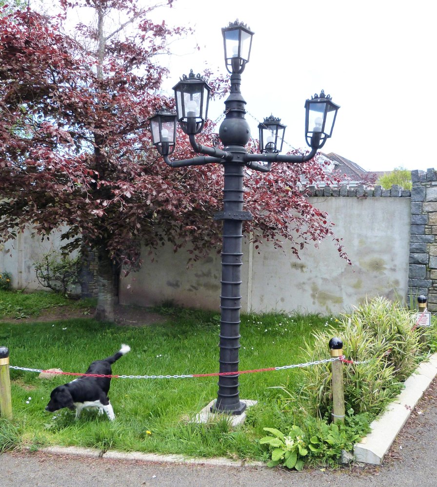

If you are having problems with quality using PLA on your current printer, I’d suggest you experiment more because there’s no reason why PLA can’t print lots of things that can stand heat and water..
Even if you get a new printer, that won’t solve your problem, not will using other filaments such as ABS and others, in fact that may even make your problems worse, small cheap 3D printers can make items just as good as their more expensive big sisters.. (It uses exactly the same principal only smaller)
Thingiverse are great for all the things you can’t make yourself, but you still need to learn to make your own projects in time, use the Thingiverse objects by all means until you can get them to work the way their suppose too, failure is not acceptable, just keep trying, it will get better.. (It’s best to start small..)
(This was made with PLA)
P.S. Not the dog..
Thank you for your thoughtful advice which is much appreciated. That lamppost is fantastic and a real credit to your expertise. I bet you could also model the dog - surely TPU filament would be the way to go 😀😉

I wouldn’t advice PLA for outdoor prints enduring hot weather and lots of sun. If you lived in Arizona instead of Ireland, the arms of your magnificent 3D lamppost would be sagging almost to ground level. Even in Ireland, I assume that you installed internal metal rods or similar to add enough strength to the structure.

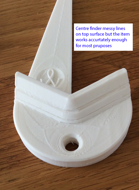

I have found some images of items I have produced and made some notes of where I think I have gone wrong but welcome any suggestions to prevent future issues. All printed in PLA. TBH I am a little embarrassed to show them seeing the standard of work being produced here but...
The PLA works in the sun.. JUST, my lamp gets very hot to a point where I can’t put my hand on it, because it gets too hot, I didn’t use any metal rods to support the arms at all, but if there is going to be a reprint, then I’ll use white PLA and support the arms next time..
That’s hog wash, we all started out much the same as you, and learned from our many, many mistakes, that's the fun of 3D printing, no ones an expert..
From what I can see with this print, is the filament looks to have moisture in it, because one of my white filament rolls has much the same issue, and I’m wait to dry it out to make a two colour sign..
