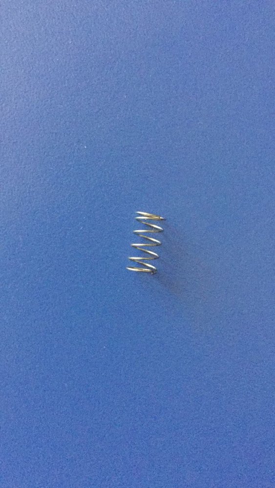

Hi, i have this printer, but the japanese version, and this problem can be solved by reassenting the
flex cable from the scanner to the logic board, check if the contacts in the flex cable are ok,
i had to repair it to work again.
I had to change this flex cable from a donor scanner, but when i made the disassembly of the scanner
i lost the position of one little spring, that i cant indentify where was it, can u help me ??
the scanner is working normally, but i know it belongs somewhere...
Regards from Brazil
Hi Japaboy, thank you for the advice.
I'll be happy to help
Please find below a picture of the opened scanner
That little spring for sure doesn't belong to the scanner unit.
I suppose that it comes from here
or here
I had a look at the part catalogue and there is no mention of such a spring
Regards from Sardinia
