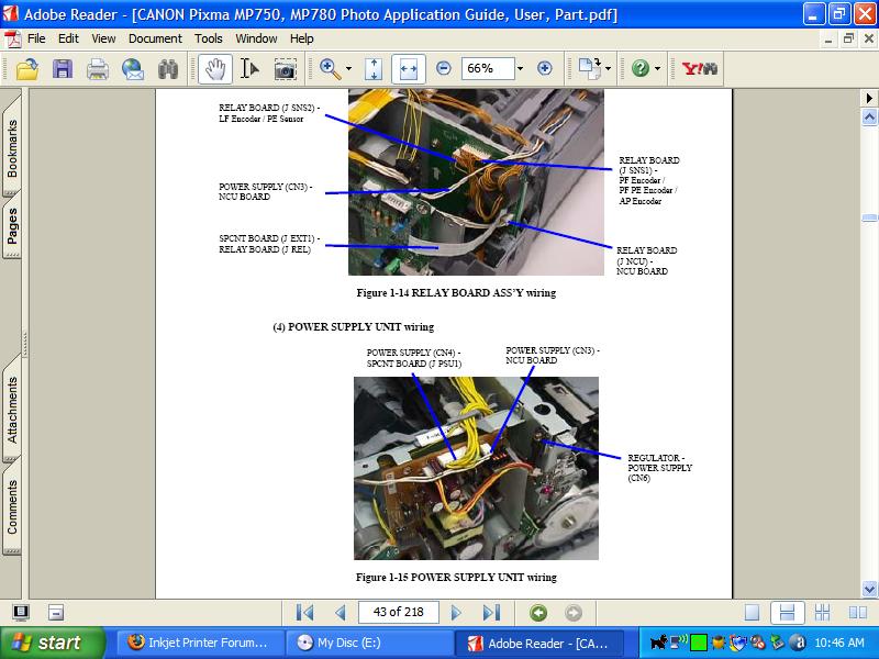

On this PCB there is what appears to be a 2-pin low voltage header immediately to the right of the 7-pin.
I have a nice image, I just can't see how to attach a file here :(
Maybe in this manual there is a pin-out diagram that details these two headers.
I'll keep looking around.

The Upload link at the top of this page is supposed to provide an easy way to post images but one other person said it wouldn't work. If it doesn't work for you, send an email to the Administrator.

Thanks all.
It's the lower image.
The connection to the left of the 7-pin is for an early model external regulator.
I have the integrated regulator and don't have this connection.
jflan
Printing Ninja
Feb 28, 2007
336
99
Vancouver, Washington
The voltage check from left-to-right @ the 7-pin connector is :
[0.0] [0.0] [24.2] [26.8] [4.9] [0.0] [0.0]

Thanks, ghwellsjr.
I will try that before ordering a new power supply.
Too bad so much disassembly is required to access those connectors on MP780 :(

jflan,... I see you finally got the voltages measured. Since the MP780 Service Manual does not list the power supply voltages, I was guessing at the voltages but the ones you measured seem just fine. Of course there could be one missing. Logic level is +5 volts, and printhead driver and motor controls are about 24 volts. So what you measured seems OK. These symptoms are not pointing to an error on the mail logic board. Try out the suggestion above you may be supprised.
jflan
Printing Ninja
Feb 28, 2007
336
99
Thanks Trigger37.
BTW, what's your take on the "missing" readings on four of the terminals ?
I sure wish that dang service manual listed the ouputs !
