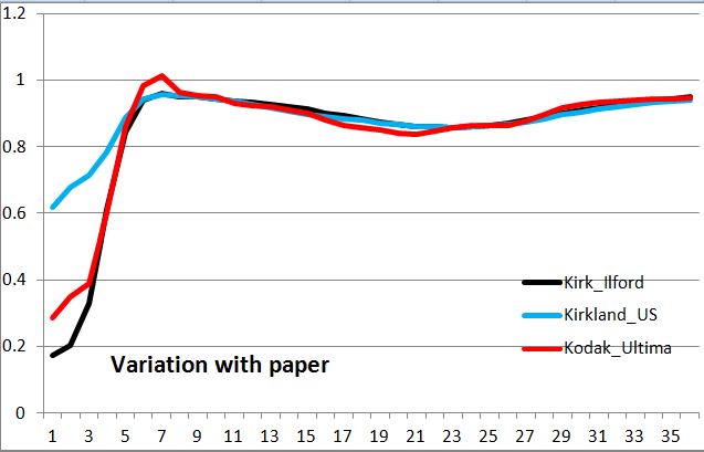

This is a small part of a spreadsheet that we did a number of years ago on fading, and it shows the reflected light from 3 papers at wavelengths from 380nm (left) to 730 nm (right). This source lists visible light as falling in the 390-750 nm band, so the far left side is just above the UV band. The Kodak Ultima shows a value above 1.0 (which seems to be impossible) because it apparently has Optical brightening agents that convert some of the UV into visible light in the 430-450nm band. Unfortunately, OBAs are usually very prone to fading from UV exposure.
In any case, the Costco paper made in the US had a better curve than the Ilford paper. As this work was done before the paper from Mexico was introduced, I have no data on its characteristics.

The Switzerland made paper is whiter than US made. I have both laying in front of me.
