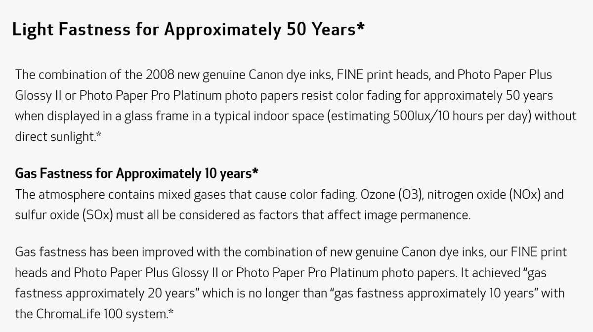

What's an extra 200 years between album buddies? ;)
Chromalife 100+? prints displayed in the open, though, lasts substantially less according to Canon.
https://www.usa.canon.com/internet/portal/us/home/explore/printing-innovations/chromalife
Red River reports Chromalife 100 (no +) is 100 Album years, 30 lightfastness and 10 yeas gas fastness.
https://www.redrivercatalog.com/infocenter/canonchromalife.html
Taking 500lux/10 hours a day with more than 15 Mlx hours I reached already 30 years. The average deltaE2000 is 3-4. That is not that much. It is measurable but whether it is really visible on a print is something different. My testing conditions can be called harsh at least with light intensities up to more than 40.000 lux, temperatures to 40°C and humidity falling down to below 30%. So the samples are really stressed. I am sure what I do is not was Marc from Aardenburg is doing, but differences between bad and good inks show up already in the first weeks. In my professional life as developer and designer we always tested to the minimum requirements. If I were Canon I would do the same. They make a test in their test facilities and tell you some figures. Under same conditions you will get this storage times. And only Canon compares to Canon. Epson does other tests.
The real problem arises when you go away from OEM materials. Non of them compare to OEM. But how bad or good are they and is it enough for what I want to do? I think, that going with Canon Glossy II PP-201 is a good way, even with weaker inks. Didn't test the Semigloss SG-201. Tests at Aardenburg show with a Pro-100 (ChromaLife100+) they are nearby with about 55-60 Mlx hours. So both are good papers.
That was my fear, that the paper would be the biggest improvment of them all. I got a small set of 10x15 Glossy II pp-301 to test it out. Will try you method and advices, hopfully the sun here won't will kill this papers on the first day. 🤣
