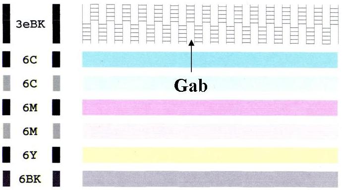

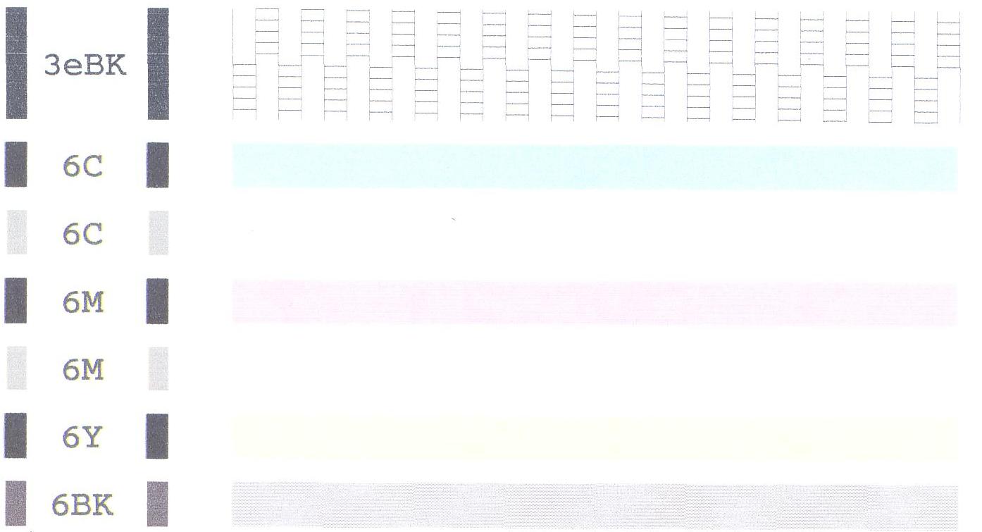

Canon mp780. Can anybody tell me what is wrong when you see this nozzle check pattern. I have cleaned the printehead several times with hot water and solvent. The patern do not change. Is it a new printerhead?
It is according to the 3eBK pattern.

aaloeb,... You should never use any kind of solvent to clean the printhead. Also, you should not use water that is much hotter than the coffee you would drink.
The picture you uploaded does not expand or enlarge when clicked, so we can't see any detail. Open the picture in you computer and enhance the image to increase the contrast. this way it is more visible to all of us. When you copied all of the image url, you missed part of it so you can do it again.

Aaloeb: your 3ebk looks defective. Missing pixels in a uniform pattern is an indication that the print head is defective. Also your C and M are missing the light colors. This is indicating you have clogs in them. Try to reset the printer, which will clear up the eeprom in the print head. If the 3ebk remains the same maybe it's time for a new print head.

Hello Inkjet Master. I have read that others have used hot water and solvent, in fact it was isopropyl alcohol I used. I have rescanned the checkpattern, so I hope it's better. I have written at the picture what I mean. It is the gab in the 3eBK pattern. I think the other colors are ok, when I look at the pattern.

I see the light C and M on your new scan. The problem is in the gap that is on the 3ebk nozzle print. Because it is so uniform it is an indication of an electronic defect. However, resetting the printer, which will clear up the eeprom in the print head, may be able to fix it. I don't know what the sequence is for resetting your printer. But a quick google of reset canon mp780 probably will find the answer for you.
