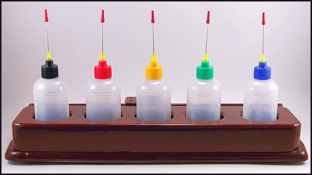

Hi,
Today I tried my first Hobbicolors refill of pigment black. Was previously using the single Black refill bottles for 3eBK that are no longer available from inkjetcartridge.com.
Anyway, what a mess I made!!! Black ink everywhere!!!
Does anyone have a methodical way to start with bottles of bulk pigment black and cleanly get the appropriate amount of ink into a syringe and inject it into the cartridge (via German method) without getting ink all over the place?
I guess I should have put the empty syringe into the hole in the cartridge first, then filled it with an appropriate amount of ink and injected it. Can't put the syringe in the hole until the cap comes off - but if it's filled the ink goes flying when the cap's pulled off (I didn't realize that till the ink was flowing all over the place...:( )
Anyway, if that's how one should proceed, does anyone know the amount of ink that the 3eBK for a pixma 5000 holds (it's a bit bigger than the other colors...)?
I have only one cartridge so I can't measure how much it needs, and seems it'd be best to pour the exact amount into the syringe to avoid overfilling or having to pull out during the fill...
Any tips would be much appreciated!!!
Thanks and regards.

Get the squeeze bottles and scabbards from Octoinkjet. Martin will sell you SquEasyFill bottles, either 100 ml or 250 ml size, complete with blunt needles and scabbards and appropriately color coded screw on caps. See the different sets here:
http://www.octoink.co.uk/categories/Refill-Tools%2fKits/SquEasyFill-Kits/
Or you can make up your own custom kits using components here:
http://www.octoink.co.uk/categories/Refill-Tools%2fKits/SquEasyFill-Custom-Kits/
You will need 2" needles for German Durchstich refill method.
Im located in the U.S. and shipping was $3 for 5 bottle set. Believe I also ordered extra needles with this shipment. Shipping took about 8 days from the U.K. Might add also that his web site has automatic currency conversion, so you will see pricing
in U.S. dollars. Very convenient detail I think. Here is a photo of my SquEasyFill bottles:
http://www.nifty-stuff.com/forum/uploads/4795_img_2203a.png

I think maybe your problem is that you are trying to pour ink into the syringe. If that is what you are trying to do, it's no wonder you are getting ink all over the place. Instead of that, put the needle into the bottle of ink and pull back on the plunger inside the syringe. It will suck the ink into the syringe. This is still a little bit messy because you can get some ink from around the top of the bottle onto the sides of the syringe but it isn't much and you can wipe it off before proceeding.
You don't have to worry about how much ink a cartridge holds. Just fill up the reservoir, remove the needle from the cartridge and let the cartridge sit right-side-up for a few minutes until the level of ink goes down a bit in the reservoir. Then you can top it off again.

Thank you both for the replies.
ghwellsjr, when I pull the needle out of the bottle, will the ink start to flow out of the syringe (with no cap on)?
The trouble was not pouring the ink in, but what happened when I took the syringe needle cap off to insert the needle into the cartridge...
Also, do you leave the syringe partially full (capped) between fillings of the cartridge, or empty the leftover ink back into the bottle and clean out the syringe?
Thanks again for the advice!
From what I understand of your description of the problem, the syringe and/or ink did one of two things.
1. The syringe plunger had been pushed in and "stuck" so that pressure was unable to escape until the cap was removed
or
2. The ink in the syringe was warmed, expanded and again pressure built up.
If that's the case, then pulling back on the plunger before removing the cap would reduce the pressure and avoid any spurting out.
Hmm... To be honest I wouldn't leave a syringe with ink in it as the potential for someone to come along and press the plunger in is a bit high..
I'm biased and sell the following kits (so best declare my self-interest) but you might want to consider one of the SquEasyFill approaches instead of syringes as they'd deal with most of the issues you've described. The down side is that they aren't quite as exact but perhaps take a look at some of the threads about the approach and see if it might work better for you.
Just a thought.
