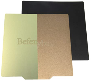

Well, after seeing TONS of videos with guys using PEI on spring steel sheets, I decided to order one. I decided to "splurge" and get the double-sided sheet with smooth PEI on one side, and rough / powder-coated PEI on the other:
https://amzn.to/33KFKgS
I've been experimenting with it for about a week and am VERY happy with it!
There's still a part of me that doesn't love waiting on a heated bed to warm up (heck, I get frustrated waiting for the nozzle to heat), but I think the Ender 3 V2's smaller bed AND 24 volt system (with the sheet metal vs. fat glass) heats up way faster than my CR10 big bed, 12v, thick glass, so I may start always printing with <gasp> a heated bed! </gasp>
... that said, I still like experimenting, so I've been playing with combinations of bed temps on the smooth and rough sides, as well as using and not using gluestick.
I found that the textured side needs at least 60 deg. for the parts to stick and then do the magic self-release when cold.
The smooth side is more forgiving and I can get a decent "stick" at 40, and even 30 deg.
I might still do cold bed + smooth-side-PEI +gluestick on small quick prints... which is like 90% of the stuff I print, and then do a fully heated + rough-side PEI for really big / long-duration prints.
All-in-all, more fun stuff to experiment with!!!
