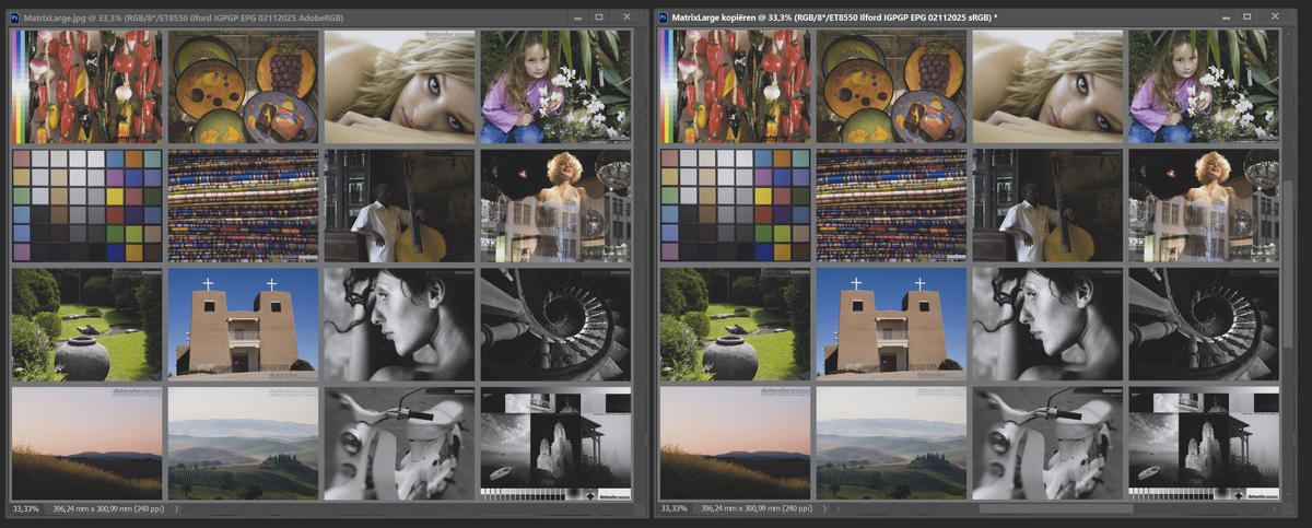

I made three profiles: One with AdobeRGB, one with sRGB, and one with ProPhoto RGB. When I printed with the specific profiles using Epson Print Layout I made sure to export a tiff in lightroom with the matching color space. I've printed all in perceptual rendering intent.
Here is the interesting part: In softproofing all of these profiles are extremly different. But the Professional one, the ccStudio one and the ArgyllCMS RGB one printed very similar.
But the AdobeRGB was way duller then the others, the ProPhotoRGB one was even more duller. The colors were way less defined, the RGB Profile had way stronger colors and looked way better to me.
Since ProPhotoRGB has a larger color space, and I made sure that color spaces matches from export to print, I expected it to be "better" than the others and not lighter/duller than the others.

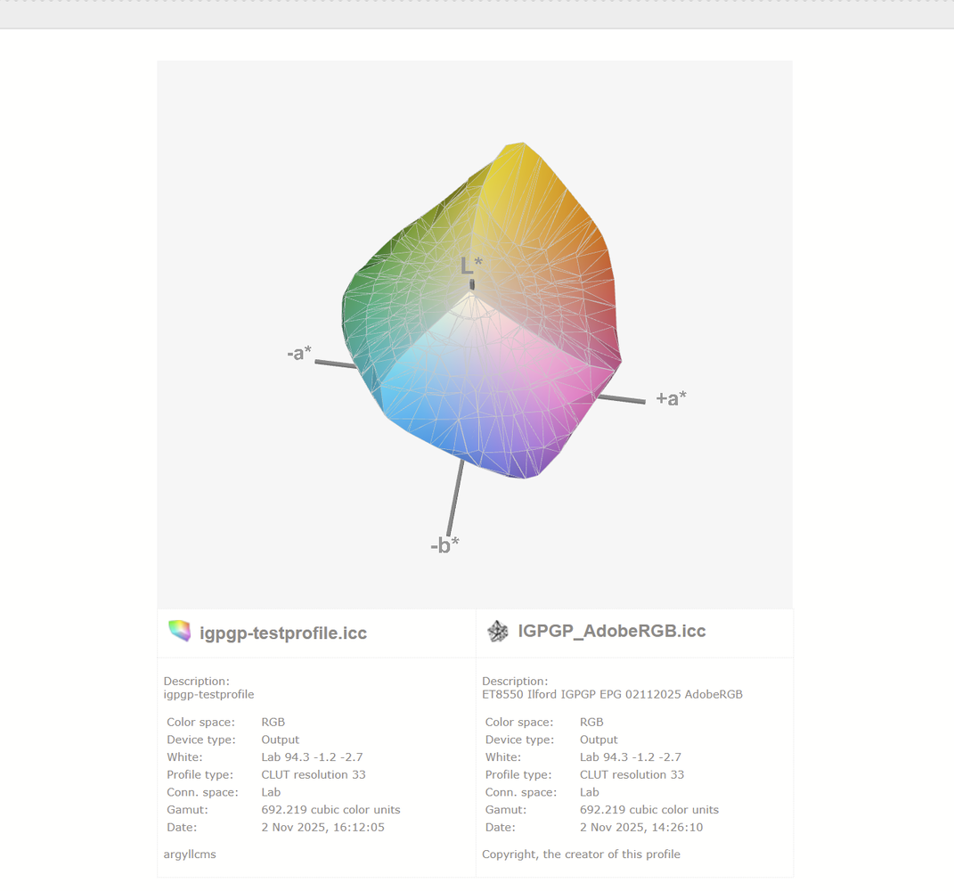

I get this with my makeprofile.bat (using adobeRGB as the reference color space for colprof.exe):
No difference in volume size and white point. Did you compare the other profiles with another using iccview.de ?

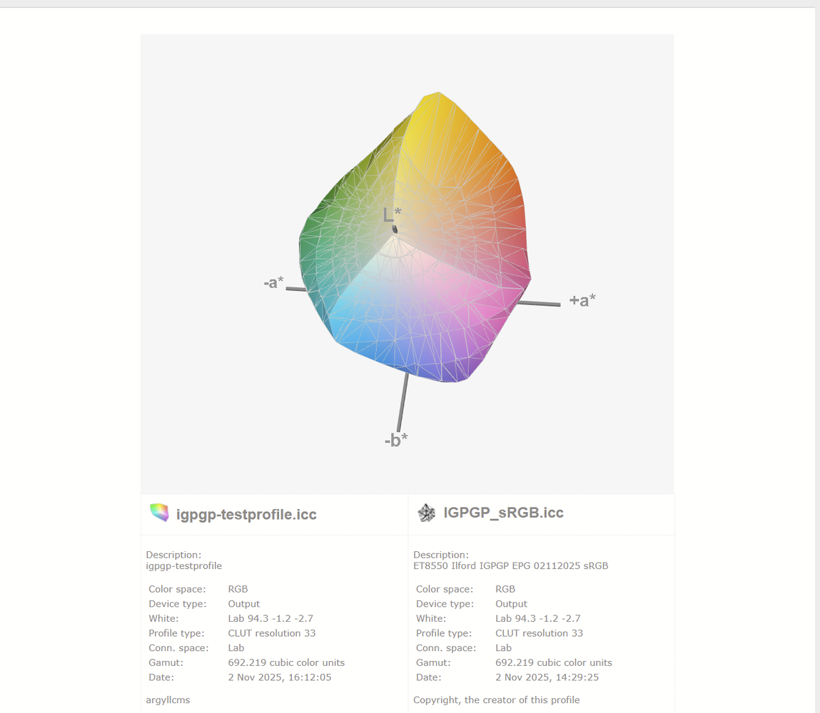

I just tried my profile against your "better" profile using sRGB as the reference color space for colprof.exe and exactly the same volume size and white point:
Yes, I compared all of the argyllcms ones (sRGB, ProPhoto, AdobeRGB) and they look exactly identical on iccview.de. Yet softproofing and printing is completely different (most difference is between sRGB and ProPhoto, AdobeRGB is somewhere in the middle)

softproofing with the sRGB vs AdobeRGB based profiles using the relative colorimetric intent (NO black point compensation):
No difference using sRGB or AdobeRGB as target color space using the colprof.exe to generate both profiles.
The difference can only be seen with perceptual rendering intent, which makes sense, since according to Argyllcms documentation you only need the source colorspace icc when making a profile for perceptual rendering.
Seems like you can skip the source color space entirely when you are only doing relative rendering.
