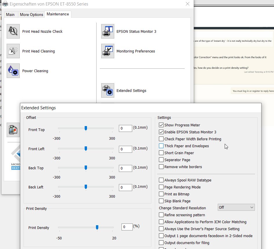

The drivers for some of the newer A3 Epson printer models have a print density setting - but not all of them, and I don't know wether that's the case for your printer.
You reach it via the Extended settings on the maintenance tab, there is a slider for the print density setting at the bottom of that windows - but again - not all drivers have it - this is a screen print of the ET-8550 .
When you make your profiles, how do you decide on a print density setting?
I'm using in most cases the standard/default value and use the no color controls setting when printing the profile patch sheets.
The Extended Settings menu looks exactly the same on the L18050 as your screenshot above
Do you know what’s the difference between changing “Print Density” on the extended settings menu, and “Density” on the color correction menu?

I don't need to change the print density settings for the profiles of papers I'm using.
I don't know the difference of the density settings - give it a try with a paper which works normally.
